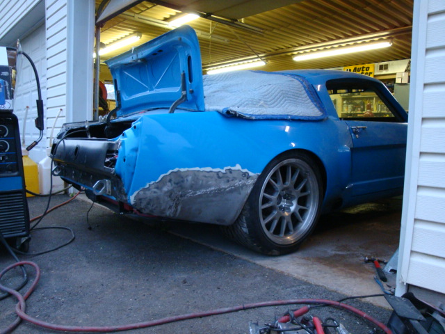

      It should be a little different, I am actually putting a fiberglass back bumper on it, reengineering the tow tabs, and putting shiny paint on it. What is this world coming to?

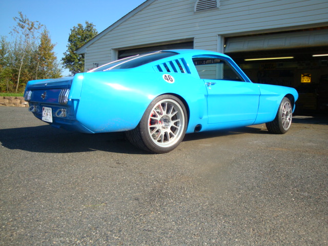

      Quote Originally Posted by Zachalanche View Post
      Put me in the 1% group. I always thought that the back of the car needed a little more upward angle on the lower edge of the quarter. That should really complement the widebody makeing it look more natural and less forced on th rear of the car. can't wait to see how it turns out.
      The rear of the car has a belly pan on it, I wanted the quarters to flow right into that bellypan. Which left the quarter higher in the front then in the back, I will have to fab a new pan to work with shape of the new quarters. You can see the difference in the pics.

      I see what you mean. I like the idea of running a bumper, it will look more complete. I am still pulling for a bigger tail light setup given the width of the car. Any lines on a new engine yet?

      the 2nd shot seems to show the gas tank dropping down pretty far; do you think you'll have to move it up as well?

      That's the angle of before picture I was looking for last night. lol
      Definitely an improvement.
      The 2nd shot does not have the rear valance on.

      The back looks 100% better! I thought it looked a little awkward before, but it was already done when I started following your build so I didn't figure you were going to change it.

      That's gonna be a much more fluid look.
      Nice line.
