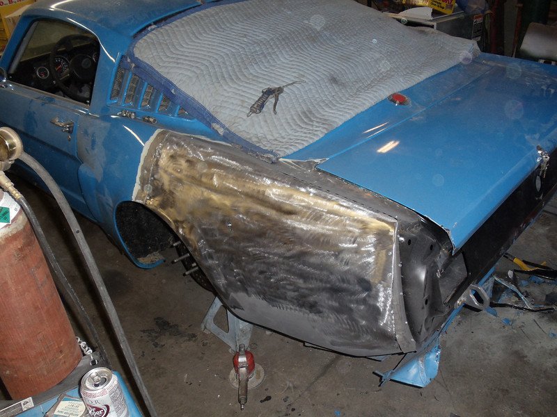

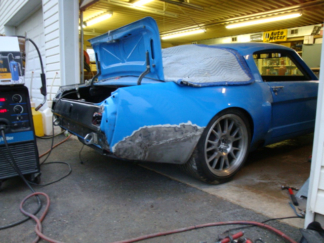

      Got most of the metal formed and fitted, I'm so used to looking at this car, I forgot how far from stock it really is. Had to stretch and roll the quarters, and add several inches of material. Hopefully I get the welding finished this week, and start smearing mud.

      Quote Originally Posted by 454bug View Post
      Looks great Ron! Did you start with a new fender panel or did you fashion all that from scratch?
      It's amazing how fast it has came back together.
      You are a real inspiration! Great job.
      Yeah Ray, it does start with an original quarter. That is what slipped my mind, it got split down the middle, the wheel flares got cut off and reshaped, 3" added to the length, and 3" to the height. A real pita, I need to build a forged engine, and stay far, far away from the wall. Ron

      There must be something wrong with me, but I always thought this car looked like it had a flabby butt. Always wanted to clean the lines up on the rear of the car. So while I'm fixing the quarter, I reshaped it to kind of give it a more athletic as$, the only problem is that it required cutting the bottom off the good quarter to give it the same shape. Plus, I will have to make a new more streamline splash panel. The sad part is 99% of people won't even see the difference.
