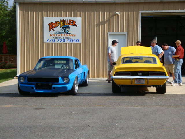

      Its funny, everyone always asks if the car was sectioned, because it looks so short. The car is stock as far as the height goes, but the early Mustangs are quite a bit shorter between the roof skin and the rocker, then a Camaro. If you look at the height of the door,its probably 3 inches shorter then a 69 Camaro door.
      This causes head room problems with taller passengers. The roll cage is as high and tight to the roof as possible. When I put the seats in the car, and drove it a bit, I took the drivers seat and laid it back which fixed the head room issues for me. David and Robert both noticed the lack of head room on the passenger side,they were the first to mention it, I guess I will have to lay that seat back as well. Payton drove my Mustang in Tenn., with me in the passenger seat. The seat is way to upright, kind of uncomfortable, never been on that side of the car.

      Psst, guys, you're looking at the wrong car...

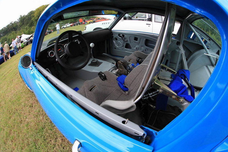

      I'm not talking about becoming a pleasure cruiser. Just some sound deadening and something on the floor and door panels. The Kirkeys are pretty comfortable along with the ride, but the noise level has your ears ringing after an hour or so.

      Just use flat vinyl over pressboard, like a cab. Maybe in the same grey colour. And industrial grey carpet.

      Maybe some panels on the doors and back seat/trunk area to seal out the extra sound some? If you knock a few dBs off of it, it might be more bearable on long trips without resorting to earplugs.

      That fish eye shot makes your car look like a "Beetle" ;-)
