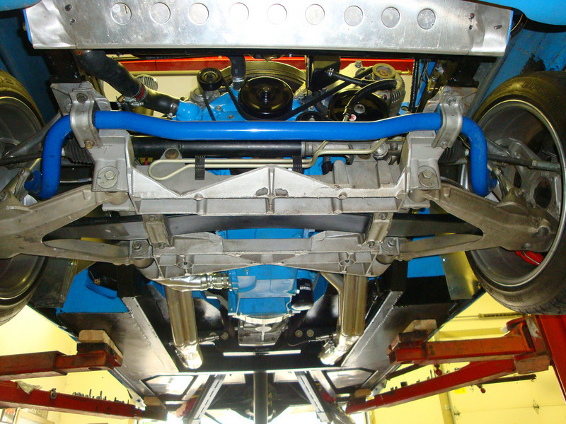

      I almost did my inner fenders like yours but decided to make sure I didn't get dents from the bottom side from rocks, it sure looks good that way.

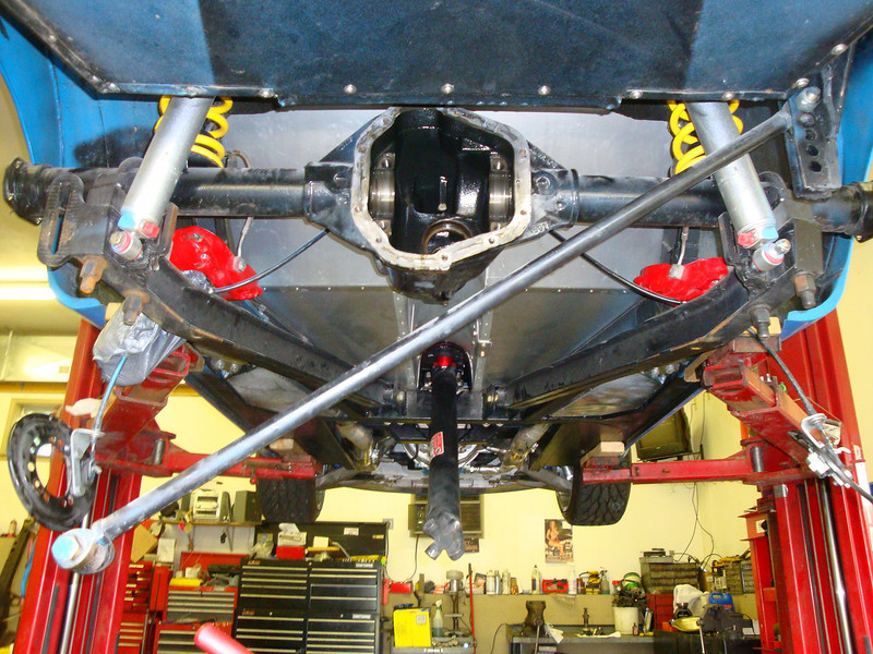

      Pulled the car in tonight to start the gear swap. My old Dodge Power Wagon had mismatched rears in it,4:10's in the front and 3:54's in the rear, so I pulled the rear gears out to stick in the Mustang. I'll put the 4:10's back in the old Dodge after Motorstate (everything is a project!)
      Found the bearing and retainer ring on the Moser axles had moved about 1/16",I guess from the side loads, I think I'll replace them and tack the ring to the axle with the tig.

      hey....when did you get a lift? oh wait....anybody need a ls7 or other simulated mustang parts?...lol

      I forgot you had the truck arm setup in there. Looks good from the bottom too!
