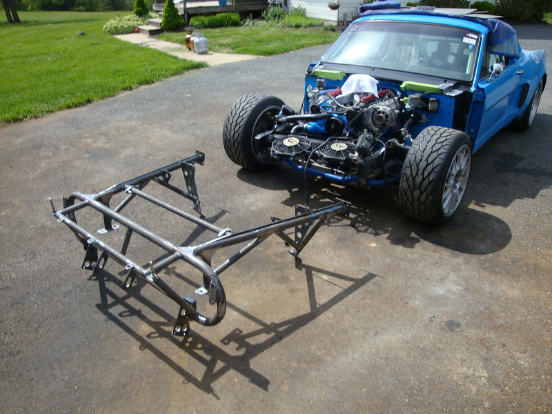

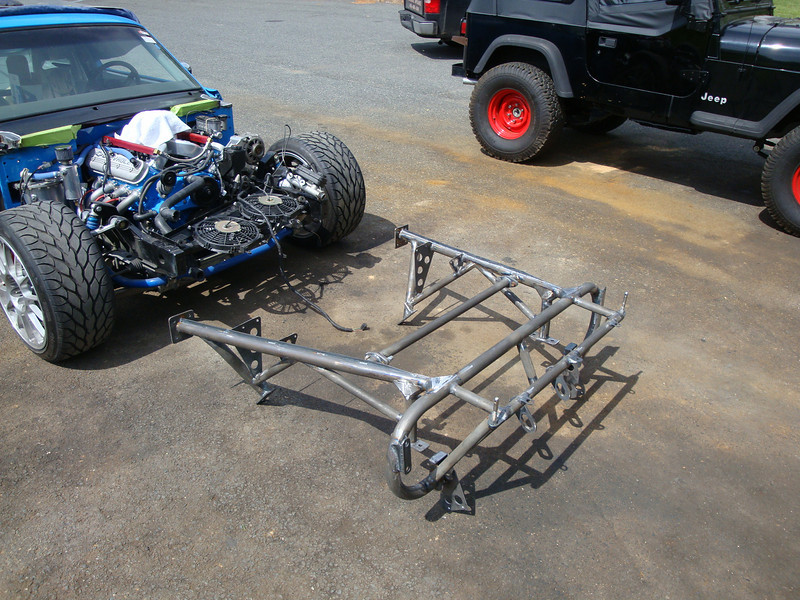

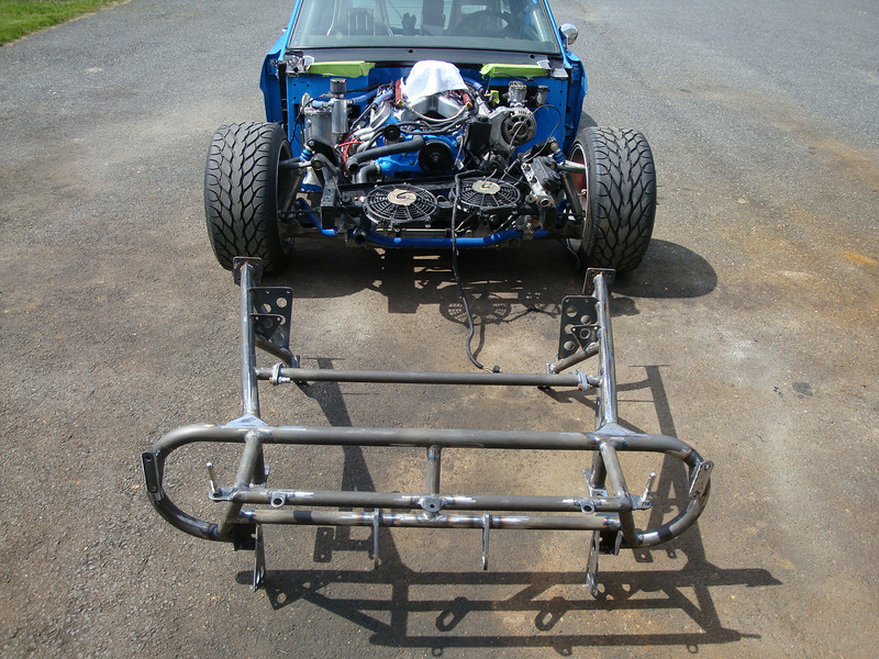

      Here is the front structure unbolted, on its way to powder coating. Its hard to beleive that with all that tubing, the chromoly structure is still 51 lbs less then the mild steel, reverse hood core support. You got to love chromoly, all except for the fact that it takes FOREVER to tig it all together.
      Kind of cool that I was able to put trailering tabs that are hidden, and poke out of the bottom of the grill, so I don't have to dirty up the back of any more shirts putting the cart on the trailer, added about 4 lbs, but it was worth it. Ron
