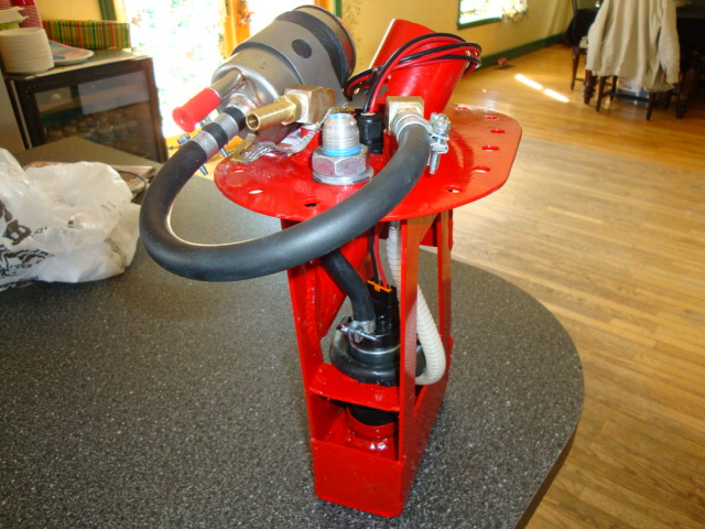

      92
      Ron what fuel cell are you using?
      Nate
      Nate Kauffman
      "She sips nitro with phase 4 heads, 600 horsepower through the wheels, shes meanness set to music and the bitch was born to run." Mad Max
    5. #365
      Maryland
      1,863
      I'm using the cheap circle track cell that Jegs sells.It is in a powder coated can,I did modify the pick up to run a internal fuel pump.Ron

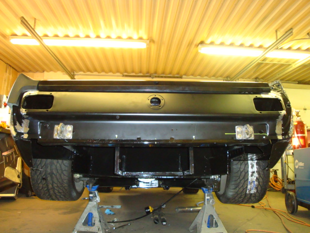

      Finally got a little time to play.Fitted the tail panel, this has got to be the most like a car this thing has looked since I've owned it.I'm not going to lie, this shot gives me a bit of a chubby.Ron
      Ron Schwarz
    7. #367
      Dec 2007
      Bakersfield,CA.
      120
      Dynomite! Can't wait to see what how the look works with what you do to the front fenders.
    8. #368
      Elizabethtown pa
      92
      They list them with a right rear pickup when you had yours apart did it look like you could modify it to pickup from both sides.
      Nate Kauffman
    9. #369
      Maryland
      1,863
      It would easy to modify,its nothing but an aluminum peice of tubing.I don't know if a dual pick up would work.If it sucked air from either side it would cause the same lose of prime.At least I think it would?Ron

      i like the rear flars alot better now how about those front fenders
    11. #371
      1,753
      Think it does to most of us. Only in a testosterone laden, manly way though

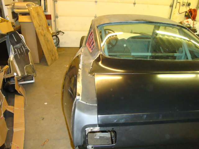

      With all the bending and stretching of all this sheet metal,I was worried about fitting the glass and tail panel,but they were a perfect fit.
      With all the different cars I've backhalved thru the years,it always amazed me how out of square the bodies get.I guess its just years of holeshots takes its toll on the sheetmetal.It was kind of nice starting with something you knew was straight and square.
      You can kind of get an idea of truley how much bulge there is in that quarter panel,from the pic.Ron

    18. #378
      333
      Yeah that's how my coupe body was. Get the front tip on center, line up the door posts perpindicular to the center line, and the back end of hte car is 1" off center. I tried twisting the roof around, also tried isting it so front and rear are on center, but then the firewall and front clip would have been askew. It might seem weird when you're building and attaching everything from scratch to a tube frame that you can't line it up, but the entire body indexes off the roof and that's what I was stuck with. YOu have to budget your time somewhere and I wasn't ready to start pie cutting and welding the roof and sail panels, although in retrospect it might have been worth it for building my "dream car".
      I too am eagerly awaiting the front flares.
    19. #379
      Jul 2008
      ohio
      1,135
    20. #380
      Maryland
      1,863
      Quote Originally Posted by preston View Post
      Don't sweat it Preston,we all have to come to a happy medium.I did a car a couple years ago,that I built the rear frame for, X'ed the corners, knew it was square.When I tried to install it in the car,the tire hit on the one side and was 2" in on the other.When I measured the car using string and tape measures,it was like 3" out of square,and didn't have any evidence of being wrecked. That is why I was so suprised as to how straight and square this body fit on this frame.
      I also bought a new subframe for my Camaro from a manufacture that will remain nameless.Couldn't get to bolt in the car{thought the car was tweeked}When I got the tape measure out and X'ed the corners on the subframe, it was 1.75" out of square.The frame was never shipped went right from they're shop into my truck,so it didn't get bent it shipment.
      It was then that I desided that I could build it better then that.There are some quality manufactures out there though,that build some really nice parts.It pays to do your homework.Ron
