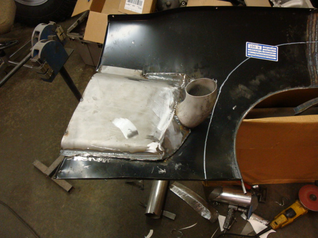

      Made the functional portion of the vents,all this little stuff really slows you down.Ron

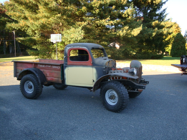

      Off topic, but what is that in the rear with the swampers on it?? Old jeep maybe? Sorry for the thread jack, just curious...

      Its my Dodge Power Wagon

      That wagon is cool, Stacey David has one like it (I think) on that TV show GEARS. Great toy!

      Yep he does! He started it when he was doing trucks...Its on rocks and 49's though

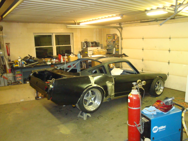

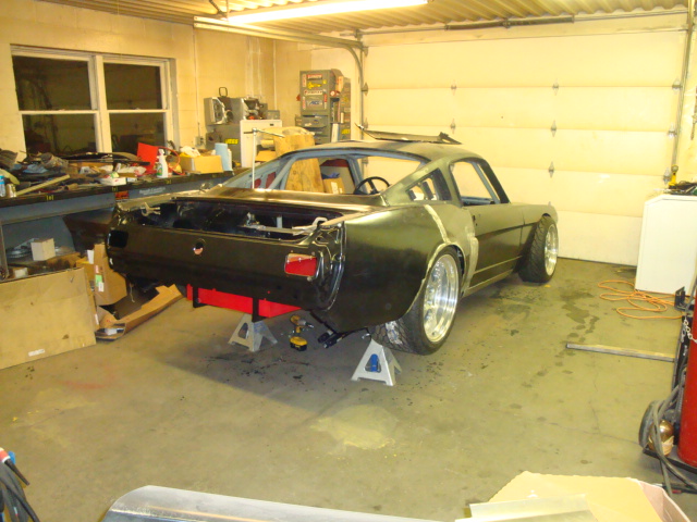

      Just finished welding the quarter and new rocker in place.Still don't know if I will put some kind of bezel around vent,but it feels good to finally have parts on for keeps.Man is the car wide,I think I'll have to call it a 66 Mustang Fatback.Ron
