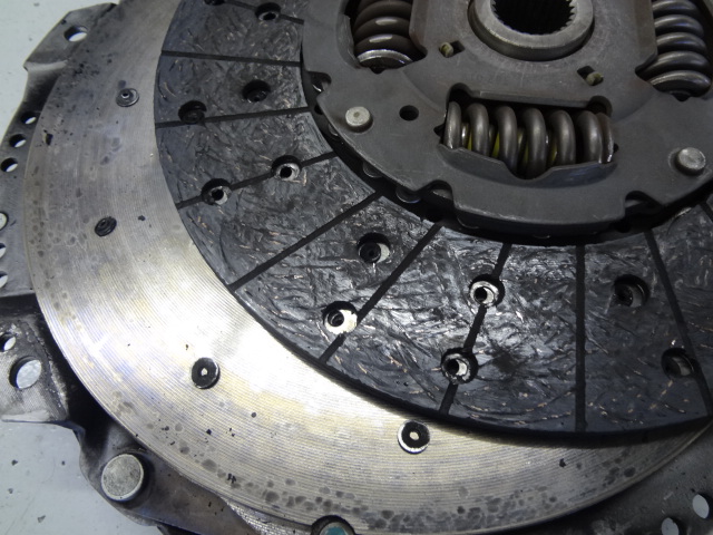

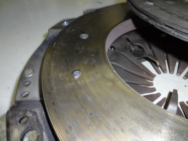

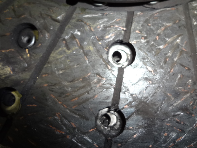

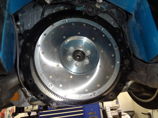

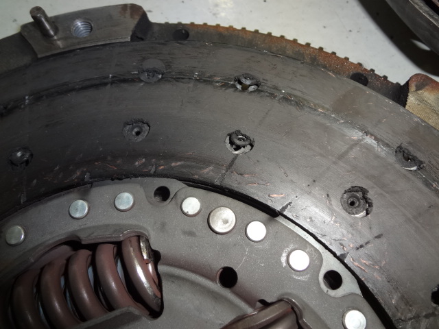

      Finally got this clutch pulled apart, kinda weird the pressure plate and flywheel look like they just came out of the box. The disc however is spent, it sheared all the rivets holding it together. Smeared the friction material over the holes, chewed the metal up pretty good.
      Not really wanting to run a 6 puck type disc due to the fact that I have driven a lot of drag cars with them, and hate the way that they launch. Called around and found Centerforce the only company to make a regular friction clutch that would handle the Hp levels of this car. Also went with an aluminum flywheel made by Centerforce.
      The install was a pain due to the Nascar style hydraulics, getting it shimmed right was a bear. Ended up removing the block spacer that I fabbed when I installed the LS7 clutch. The weight difference is about 14 lbs total between the LS7 clutch and the Centerforce. Driving is a lot different, the car launches as smooth as the LS7 clutch, but revs a lot faster.

      With a dog box trans being able to upshift and downshift so hard, I would imagine a single organic disc would have a hard time keeping up. Was there a twin-disc option for your setup? I've been running an LS7 clutch in my C5 but my shifts are slow and lazy compared to yours.
      Justin Snow
    14. #2154
      Maryland
      1,863
      With the bellhousing/nascar style hydraulic throwout I'm running, I'm kinda of stuck with a single disc. I could have run an iron puck style single but I hate the street manners. Could change everything out to a Tilton style, but I would be looking at several thousand dollars. In talking to all the different clutch companies, and a couple of transmission manufacturers, the twin setups generate a lot more heat in the trans when used really hard. I'll abuse this Centerforce setup, and we will see how it goes. I'm almost sure this engine will be pulled from this car, be attached to a T56 Magnum, and set down in my AMX when its done. I do think this car will end up with Ford power in it.
