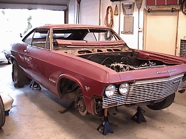

      Hi all, I have been hanging around the forum for a couple of months now and am impressed with the amount of knowledge and quality projects going on here. I am looking forward to learning and sharing. My name is Skip and I am working on a 1965 Impala SS that I acquired when I was 14 (21 years ago already!!). I have done numerous things to it over the years...countless engines, transmissions...etc..you know the story. This time I am going to do a version of the "Pro tour" thing. This is a "more time than money" project (so no laughing! :icon_razz ). I stripped my donor car (96 Camaro SS) and am using everything off it that is feasable (and some parts that are not). So far I have built a custom sub-frame to hold the Camaro K-member and suspension and grafted it to the original frame. I have also fabricated a new firewall and modified the cowl to accept the Camaro air conditioning, booster, steering column, and wiper motor. I also plan on using the LT1 (with yet undecided power adder) and 6 speed trans. Rear suspension is also undecided as of yet....maybe "truck arm"....what do you guys think??

      Now, what do we think? Hmmm.... Are you sure you want to ask us this? Well, Skip, since you put it out there, I say three link. You've done quite a bit so far, and it looks rather impressive to me. Very good work so far. Keep us all up to date on your bad ass ride.

      Welcome to the site, Skip. Nice work on the Impala so far! I agree with Allen on the 3-link for the rear suspension.

      Most impressive, Skip, welcome to the site. You know we're going to ask for lots more pics of the stuff you've already done, right?

      Welcome. I love the idea on using the 4th gen K member. Several of us have brought that up as a cheap performance front suspension, but no one has a platform wide enough to stuff it under. I would definitely suggest down tubes tied to your torque boxes to keep them from twisting off the frame. Truck arm would be cool under that big car as well.

      MuscleRodz, thanks for the input. The boxes each have about 28 linear inches of weld connecting them to their respective frame rail.....they shouldn't be going anywhere...lol . However, I do have plans for fabricating a strut tower type brace to add further rigidity. I have also reinforced the top center of the firewall and cowl to add a triangle brace to it and the box towers as an additional option.
