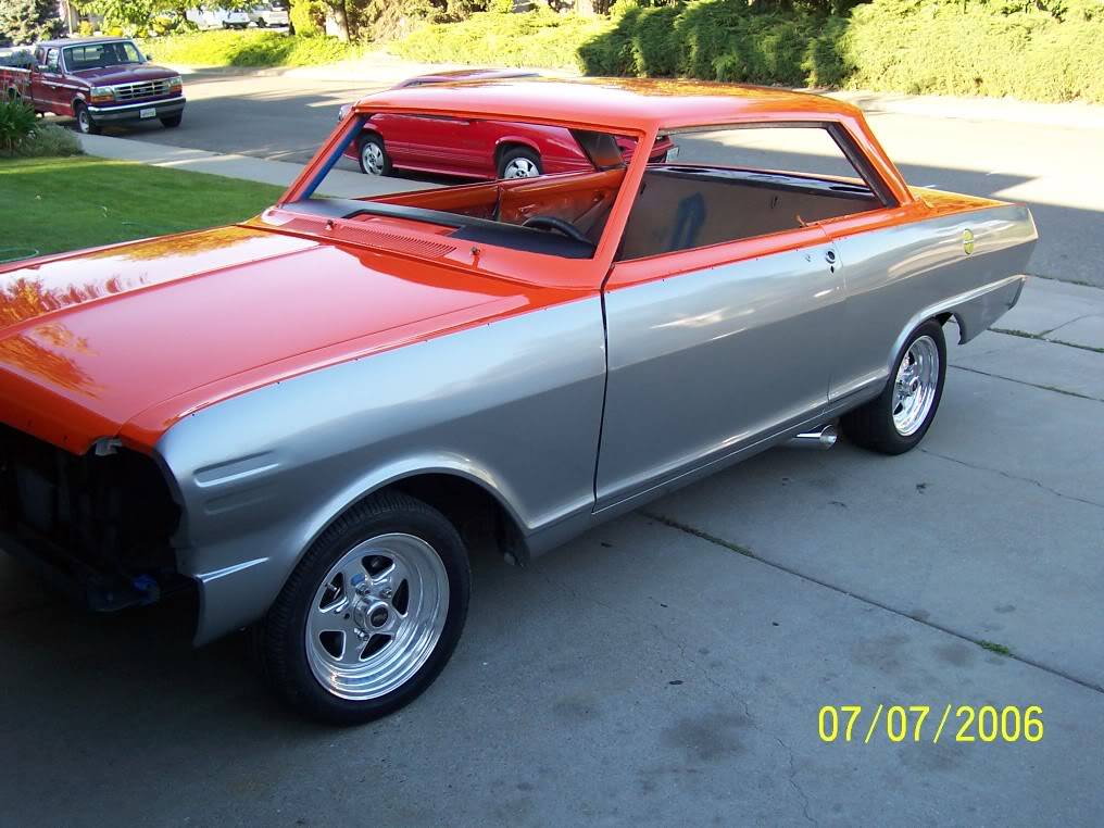

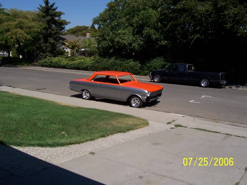

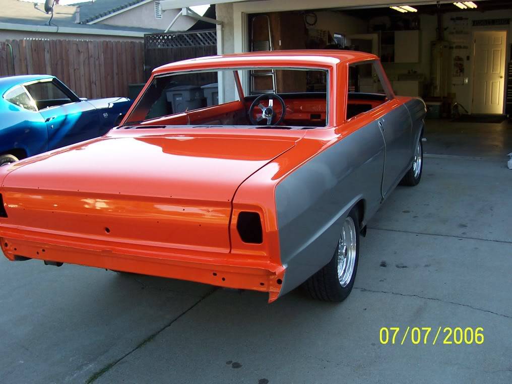

      here is my bros car not the color u are looking for but u can see how good the clear looks good whne layed down wet.(car just came from the booth its not wet sanded yet) they paited it by taking the car apart doing the jams and then hanning everything then painting it. he has hok white sealer on it with 4 coats of each color and clear

      Nice pics. The gloss looks really nice. I see you painted with the engine in the car. I may do the same to reduce the possibilities of scratching the paint.
