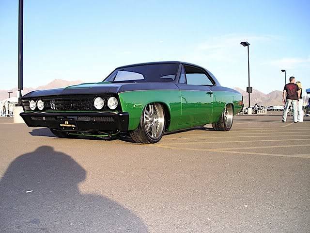

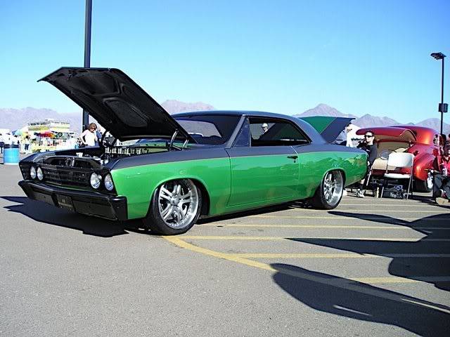

      On our DW Motorsports 67 Chevelle, we put Rushforth Wheel's 19x8's up front with a 4.75" backspace, and 20x10's in the back with a 6" backspace.
      You be the judge:

      Do the 20x10's fit in the rear without modding anything or did it take a lot to get them to fit. Just asking because I'm limited on workspace right now and I'm just wanting to change the look of the car for so I can ride for a year or 2 and get ready to completely redo the car.

      10" goes in with NO modifications. Call us, we can order the right backspace for you.

      was that a stock tub? car looks sick!

      Is the car on bags? Just noticed those photos were from 2007..Not sure we are going to get any info on the car.
