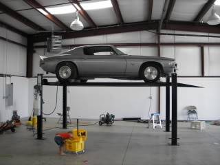

      with a four post lift, you can get hydralic jack option and still be able to lift the car to remove wheels and do your suspension work... it'll be extra $$ but it'll be a good option to have... just take a look at this pic...
