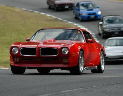

      This pic from Lime Rock is from a few years back but shows the ground clearance

      First, NOT A TA, that is a really, really, good looking car!

      Thanks for the compliments guys!
      73 TA
      Thats a great looking car! I had a white 75 TA 400 auto with that sticker package on it I sold a couple years ago.
