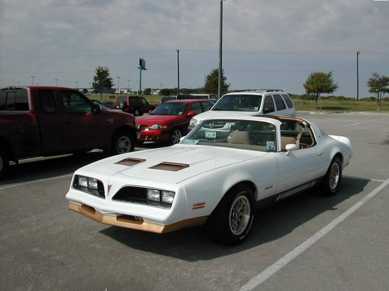

      yeah, i was thinking along the same lines, till i saw this car...
      and did this chop....
      Jan 2007
      212
      Yeah, that's cool... either way you can't go wrong! How about RallyIIs up front and Flakes out back!?!?!? Just kidding!!!!
