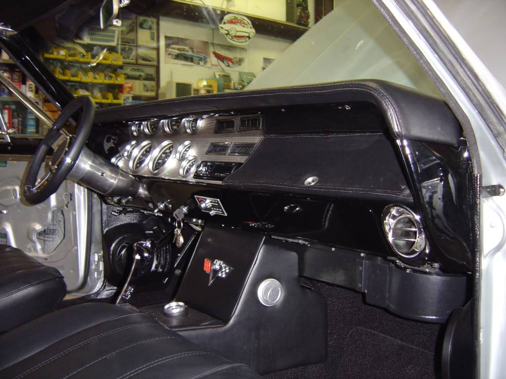

      Awesome! I especially like the interior.

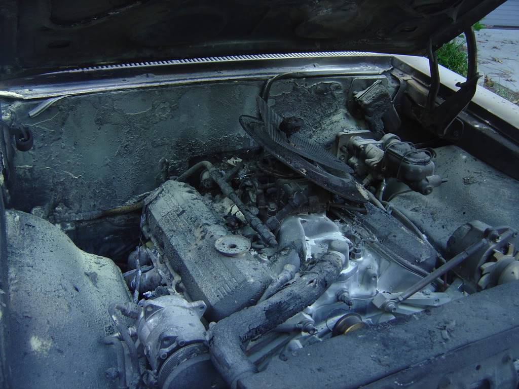

      A sad update on this 66 Chevelle build. Today the customer called me sobbing, I could barely make out what he was trying to tell me. He was standing in front of his car watching it burn. Not sure exactly what happened yet, but it was an engine fire and gas related. I rushed to the scene and damn near cried myself. What a horrible sight. The engine will survive but most everything else under the hood is trash. Melted the bowl off the back of the Holley. Said it knocked off, he rolled to a stop and saw flames. It had a safety pressure switch for the fuel pump, but it looks to me that the fuel pump was feeding the fire. I'll know more when I can break it down.

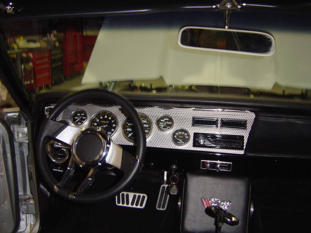

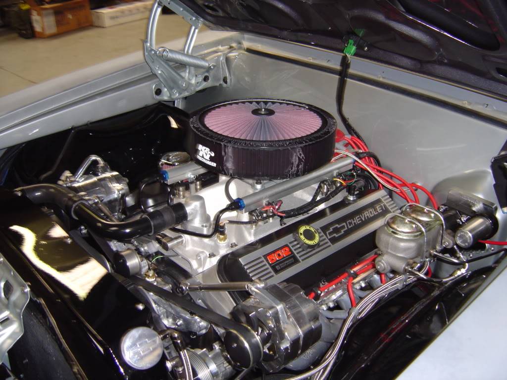

      You guys may remember this post from last fall. My customers 66 Chevelle had an engine fire and was nearly destroyed. Well, It is nearly back on the road. I have tried to improve everything on the car. The 502 now has Accel's Thruster DFI. Should pick up 60 to 70 HP. I did the engine compartment even cleaner. Went to black paint on items that had finish damage but were still good. Believe it or not that is the same valve covers. I built him a custom dash. Just a little nicer than the Covan stuff that burned. The car is at the paint shop getting a Cortez Silver and Gun Metal Gray paint job. And man am I glad to be nearly finished. Seems like I have been working on this car since fall of 2006. Except for the nine months he had it, I have.

      He had a sticking secondary float. It backfired and a little fire started. If he would have restarted it would have gone out. He panicked jumped out leaving the switch on and fuel pump running plus two big Spal fans adding O2. Fire lasted about two minutes.

      Thanks Herb. It did turn out nice. It is a whole bunch more work to recover one from a fire than to just build one. Tom has it now for the paint and I will only need a day to finish afterwards. And there is still a little fine tuning on the EFI. Most likely Ryan at RPM will get it for a dyno tune. It is quick but the Elky has him covered.
