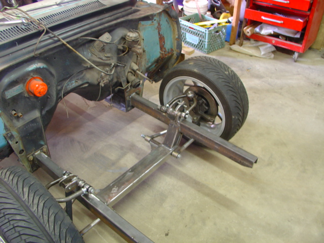

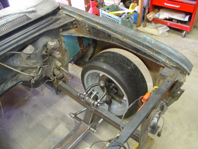

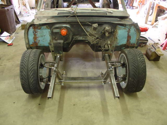

      WHeels are 18x9.5 and 18x8.5, tires are 265/35 and 225/30. They were off of a new 350z, and amazingly they fit with a ford explorer axle!

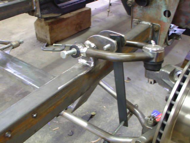

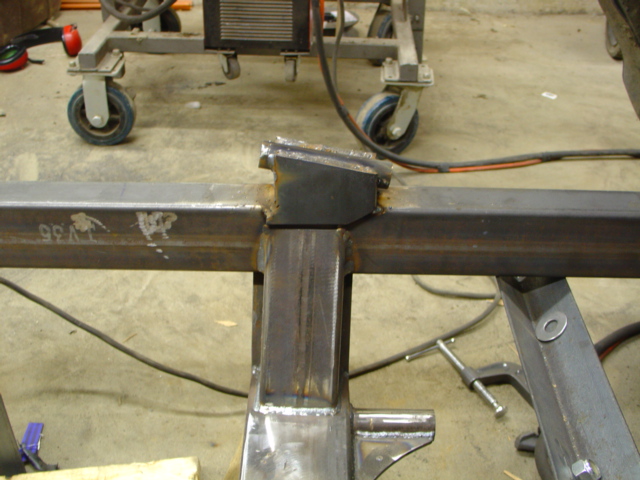

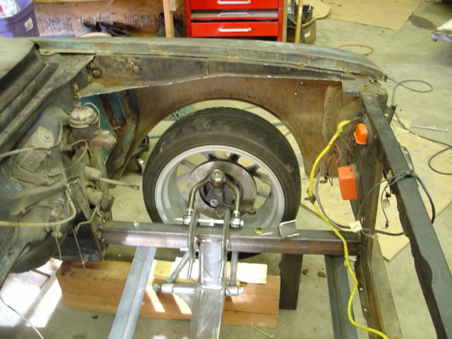

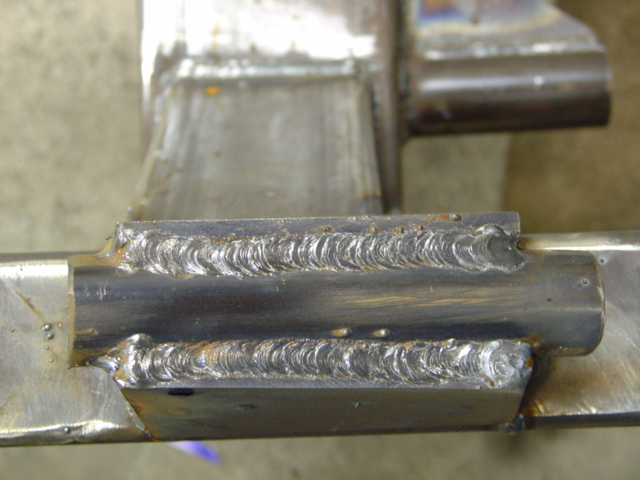

      Got some work done, I need to build the upper control arm mount and the coilover mount, weld it all up and its rolling!

      Quote Originally Posted by rickk
      poppy . that is a hell of a job keep up the good work .
      rickk

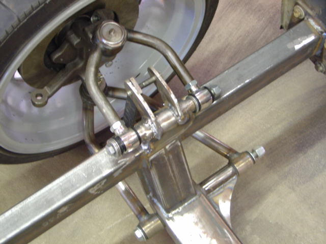

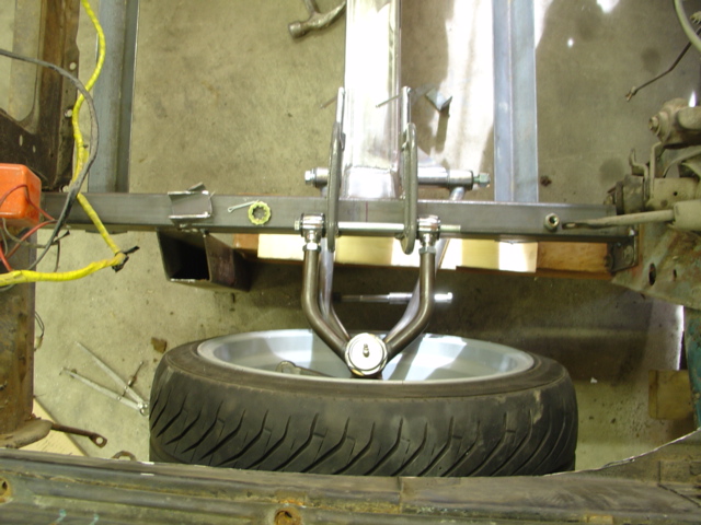

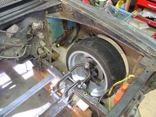

      Thanks rickk! Heres a bit more from last weekends work:
      It's rolling......phew what a load off! Things to finish:
      Tabs for steering rack
      Down tubes from firewall
      Buy coilovers
      Make engine mounts
      1966 Volvo

      Any updates,how did you figure out the angles for the uppers,what grade are the bolts running thru the arms to be strong enuff to hold the weight
    9. #49
      Abbotsford, BC
      359
      I had a friend send me some dimensions of one of the popular brands of front clips, and used that with a lot of research to set it all up. The bolts on it are Grade 5, they came with the A-Arms so I would assume they are strong enough for lightweight car. No updates for a while, i've been building a link suspension for the front of my rock crawler, so the Nova has to wait!

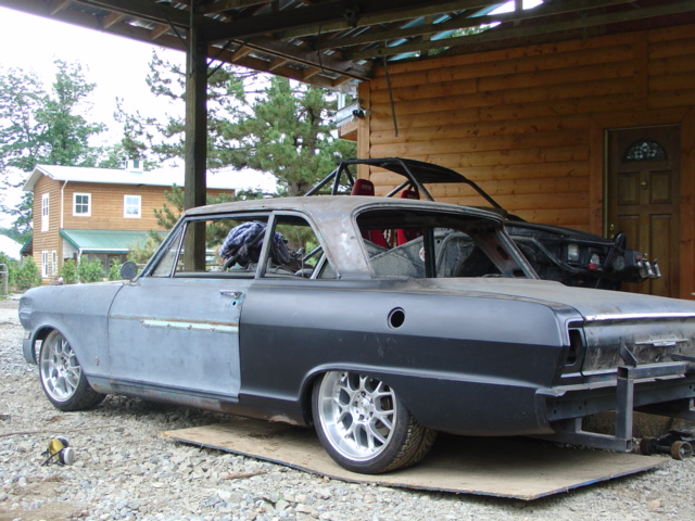

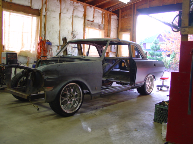

      This is how it sits now in my gravel shop.
      The stance has changed since the previous pictures, lowered the front by a couple inches and same with the rear.
      And I ditched my clip that i built since it was kinda boring, and had a friend build this:

      That front clip looks cool. The new stance looks better too. Good luck with your shop. I'm looking forward to seeing progress on the car too!

      In the car? Custom made, MII geometry and spindles.
      In the Crawler? Dana60...welded diff.
      The crawler is undergoing extensive renovations too...if you noticed, it has no roof or windshield anymore. Going full buggy!
