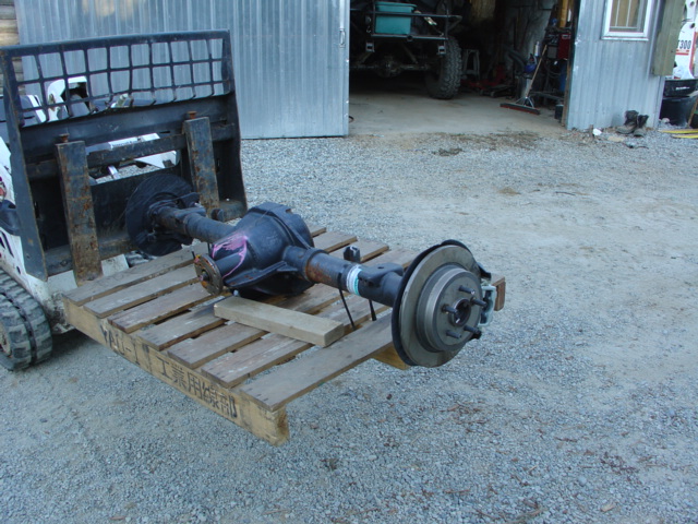

      My new rearend arrived, ford explorer 8.8:

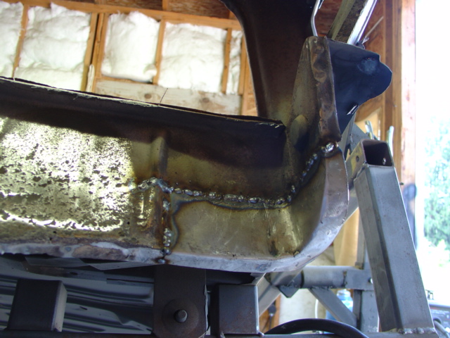

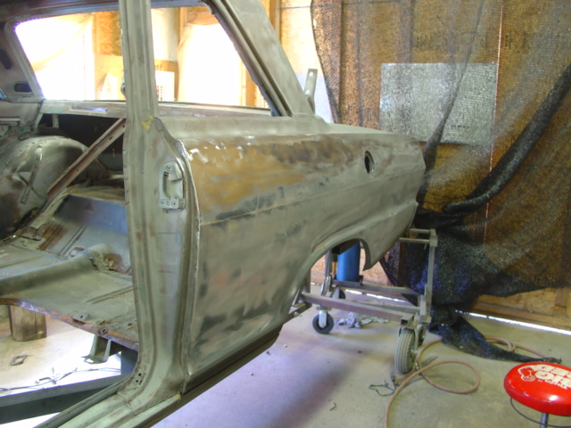

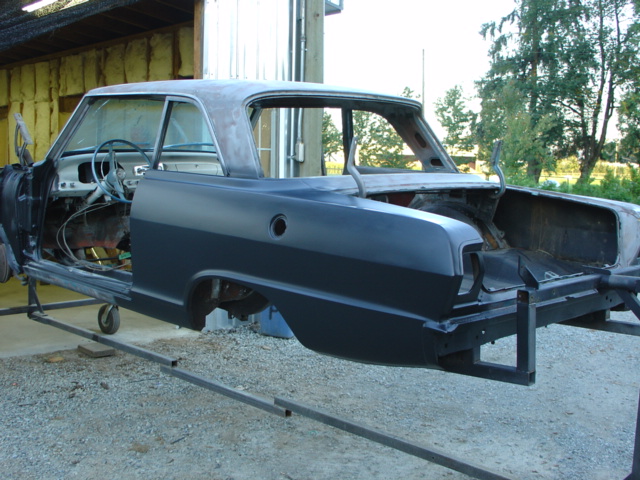

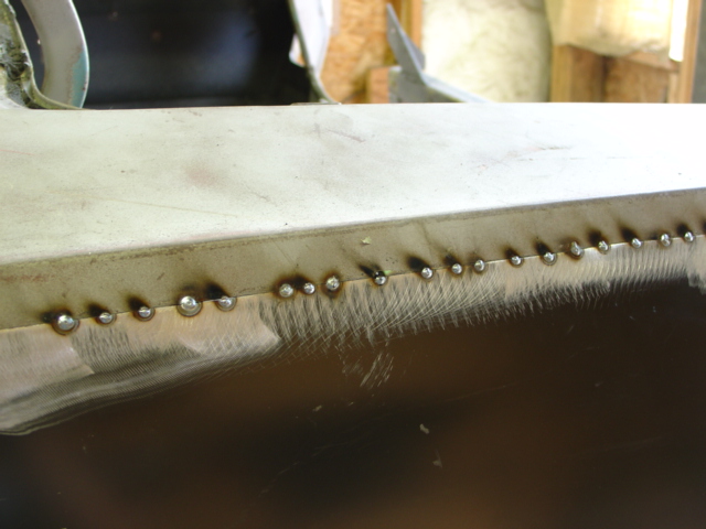

      Got the 1/4 panel done , it turned out pretty decent, I found a bit more rust and had to make a little patch. And of course I got it a little too hot and warped it a bit at the top. :sarcastic:

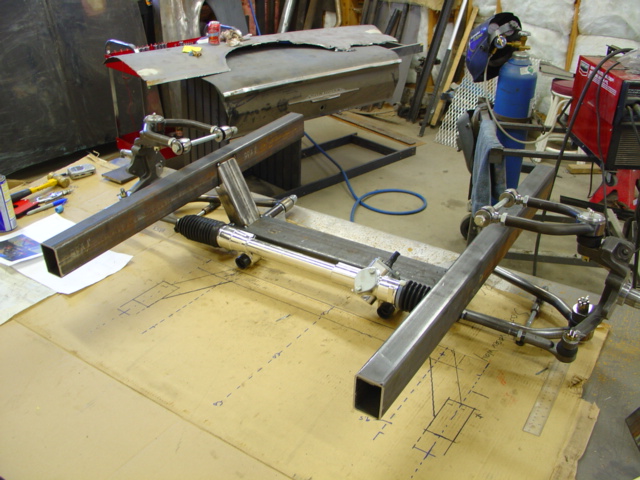

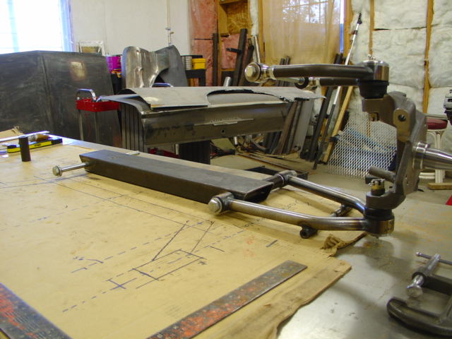

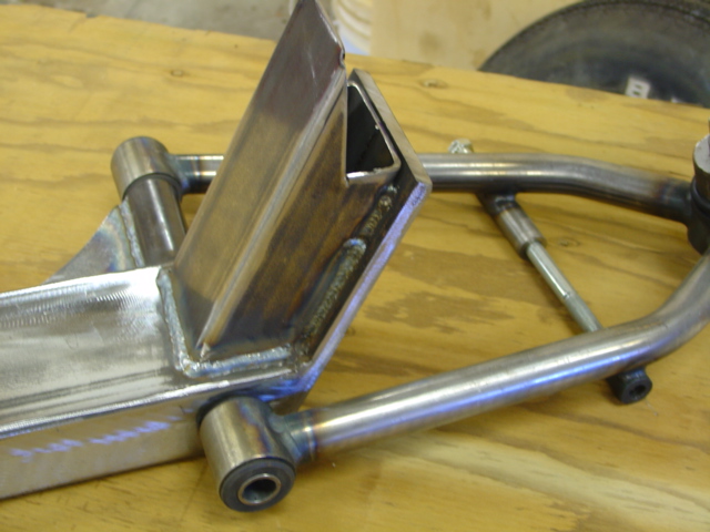

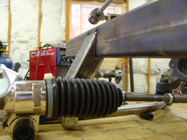

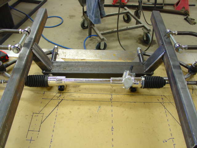

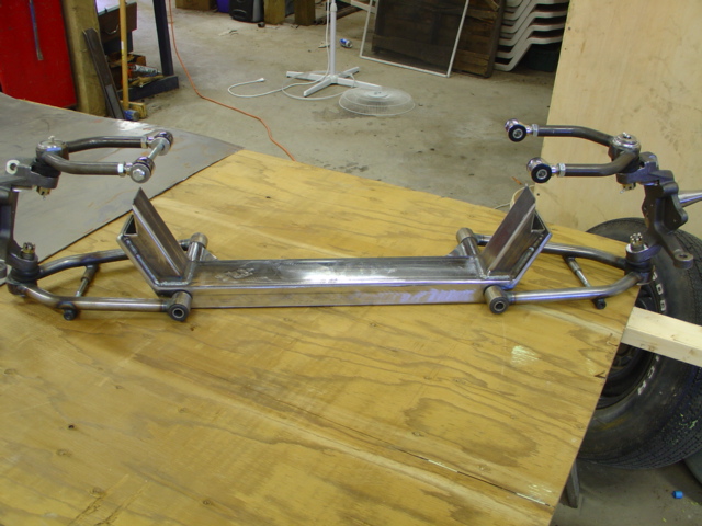

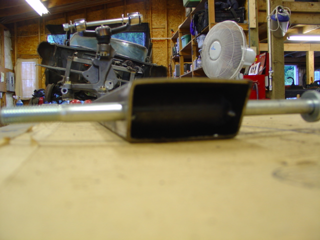

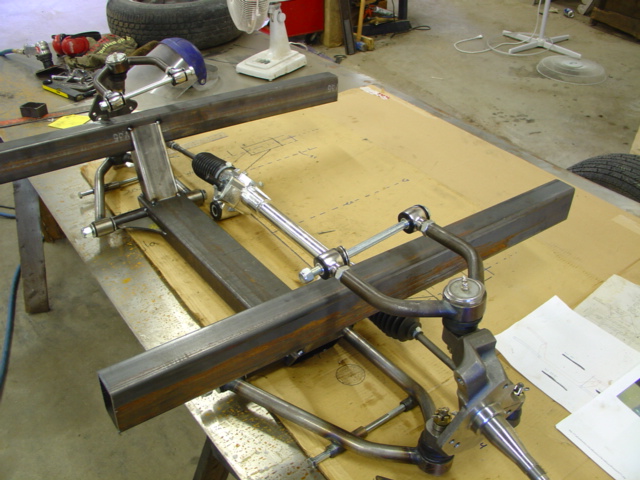

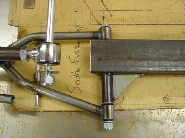

      I sourced dimensions of a few of the popular brands of MII nova clips, and have based mine on those dimensions. Here is a quick start to it last night, ignore the backwards spindle though. I'm going to run 2x3 tube frame rails with 1.75" round support tubes up to the fire wall for strength.
      Blurry pic, but the inside of the frame is sleeved with some 3/8 wall tube.
      Today I got most of it cut and tacked, just need to get some steel for some gussets, a bit of DOM for the upper control arm bolt to rotate in, and some little bits to mount the steering rack. But its coming together nicely!

      Todays updates:

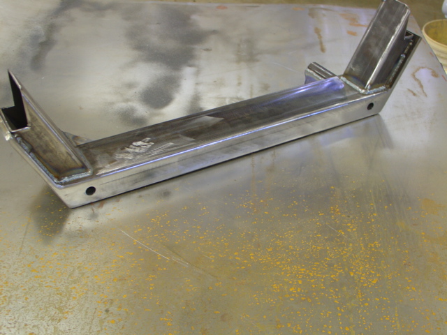

      Crossmember welded up and blended.....just need to get the car off the rotisserie to finish it up.

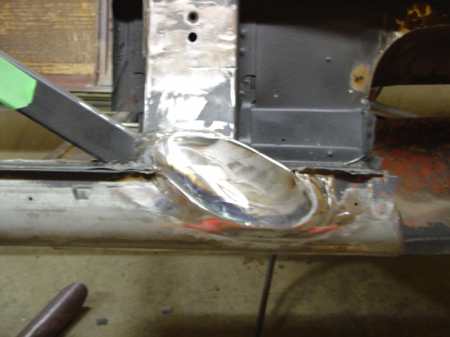

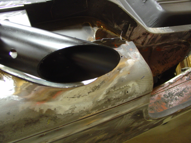

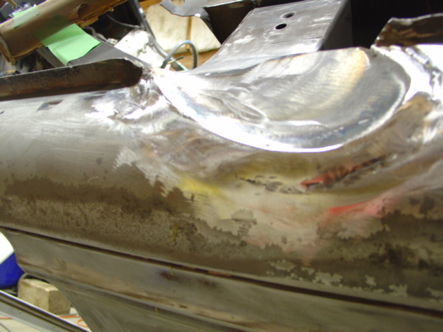

      And I've been wanting to do this for a while, and I figured tonight was as good as any... The plan was to have the exhaust exit before the rear tires, but I didnt want it hanging down, I wanted it to kinda blend in but obviously there isnt a ton of room with the way the factory "frame" is built, so I did some notching and blending and building and blending...... :D
      This is the rocker upside down on the rotisserie
      This is my PVC exhaust tip, its 3" diameter.
      1966 Volvo

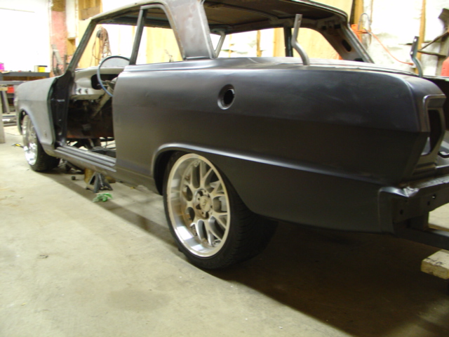

      Im just trying to get it off the rotisserie since my new wheels and tires are arriving next week....and I want to see it on wheels! So hopefully in the next 2 weeks it will be back on wheels!

      Very nice, I am always so envious of good fabrication! curious though, how did you do that frame without any jigs?
    14. #34
      Abbotsford, BC
      359
      I was thinking of going with oval tube too, but I'll stick to round for cost and simplicity!
      What frame do you mean Yody? The front subframe? I havent built the jig to get the new frame rails setup, thats next once the car is on the ground.
      1966 Volvo

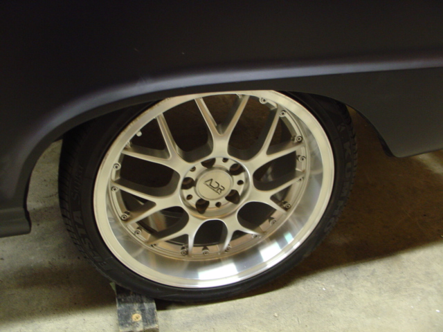

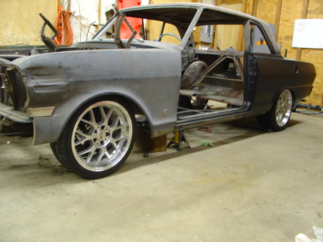

      Finally these little fellas arrived today, one needs a bit of repair, but all in all a good ebay deal on wheels and tires!

      wow sweet wheels ..they look good on there!!

      Sweet ride! One of favorite cars. What size wheels and tires are those?
