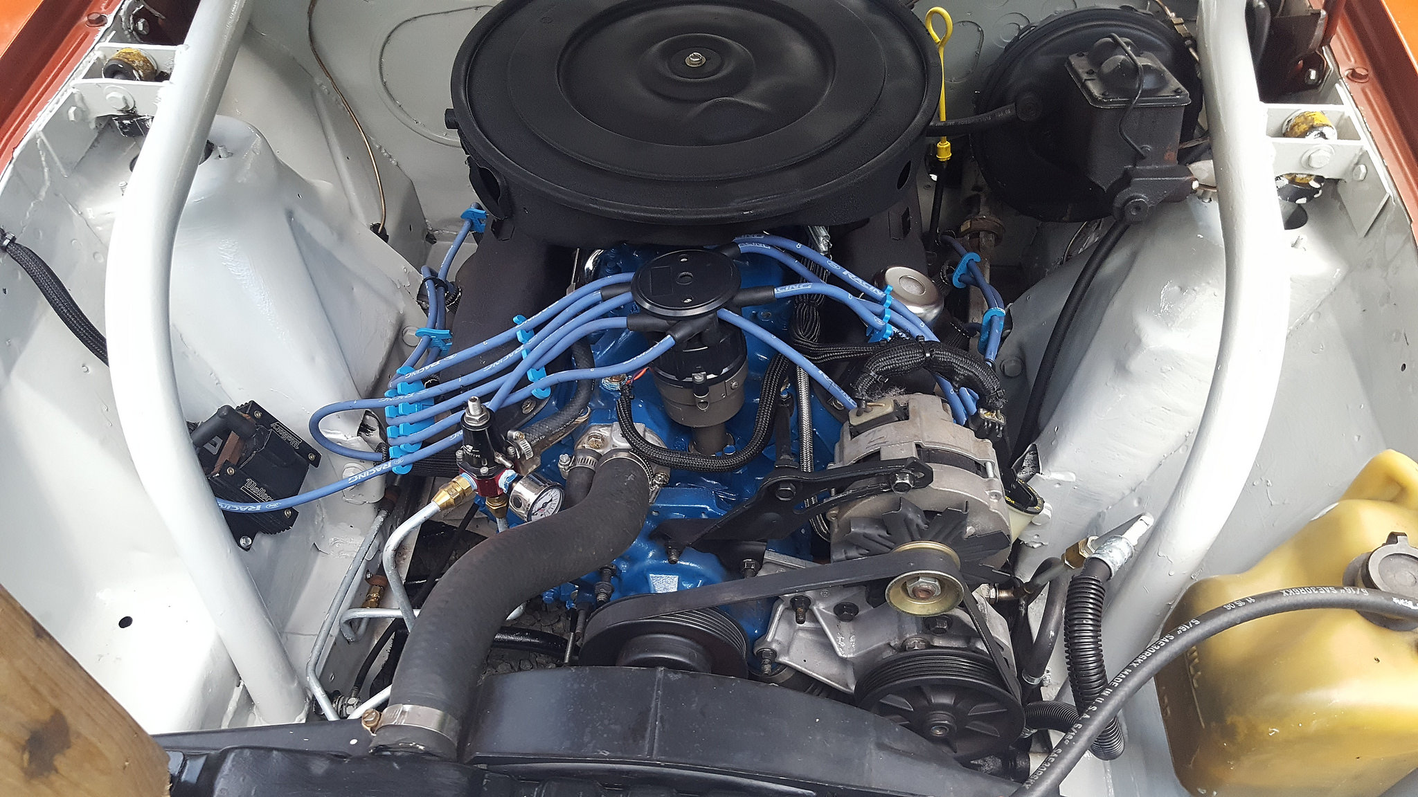

      In this installment of challenge car insanity. I break lots of stuff and get screwed/saved/come out slightly ahead.
      A little housekeeping first. On another forum, the comment was made that our scrap pile seems a little too convenient to be true. Like im lying/cheating. Which im not. This scrap pile has been collecting for a couple of years now, as scrap was down, we were busy, etc. There’s probably 3 houses, and 8 or 9 cars worth of **** in these piles. But I wanted to take photographic proof to prove that I am just that damned lucky.
      First up, our last challenge car night together didn't go according to plan. We had carb issues, running issues, etc. To the point where we hydro-locked the engine when the cab bowl on the primaries overfilled. But before we get there, ill back up a smidge.
      We started the night with a short list. Check plugs and headers for tightness. Bleed brakes. Install a lap belt. Install lights. Get running and idling. Test drive. Simple, right?
      Right. Sure. Go ahead and laugh now, because you and I both know it aint never that easy.
      So, we put Dallas on headers and plugs, me on wiring, Steve on Steve stuff. Dallas took three hours to get the 5 missing header bolts in and the spark plugs on the drivers side tight. Its not that Dallas is incompetant or lazy, its just that dad gum difficult to get to ANYTHING on the drivers side. Especially with the spark plugs being angled, the headers made for a different set of heads, and the steering column being essentially through the primaries in between the two. But he got it done.
      While he was doing that, I was doing wiring. Installed the alternator plugs stampie scored for me (2 bucks at his junkyard), hooked up the headlights and spotlights that came with the car, hooked up the side markers and such as well. Still don't have brake lights, but im not sure why. Haven't really looked yet either, which you will see why shortly.
      Heres pictures of the lighting. You can also see out tow hook better.
      While we were doing this, Steve was nut and bolt checking things, servicing the fire bottles, and making a dash cap out of gas flue from the scrap pile. Im pretty sure that the flue came from a rental house rehab in china grove, but don't quote me on that.
      We also spent an inordinate amount of time and brake fluid to finally get the brakes bled. And ate the paint off the trans tunnel. But we got that done. And the leaks fixed. Which meant it was time for a test drive!
      Except it wouldn't idle. Or run consistently. While I was in drivers seat monitoring gauges and keeping it living, Dallas and Steve were setting timing (by ear, as there is no freaking way to actually get a light on the pointer on the drivers side, and the passengers side pointer has no corresponding marks on the balancer) setting float level, trying to bring the idle down from 2k, etc. Fought us every step of the way, and then overheated. Joy. While we had the key running for the fan to cool it off, we noticed the strong smell of gas. Discovered that the primary bowl vent was spewing gas even after we lowered the float the whole way. Hydro-locked the engine. Done for the night.
      Next day, I drained the oil, changed the filter, and pulled the needle and seat to see if it was stuck. It was. With this.
      After that, got the float set. Then, found out TV cable was causing the engine to hang at 2k by not letting the throttle blade close completely. Little bending of the bracket cured that. Added another 1/2 gallon of coolant, and overheating issue went away. Replaced the fragged rear u joint, finished filling the trans with fluid, and began to bleed the power steering system. Promptly blew our hose splice all over the shop. Done for the day.
      This should be simple, right? Well, its not. Late model o ring jeep box, mid 90s ford pump. No way to get there from here off the shelf, or cheaply. What I wound up doing was buying a new jeep hose (15.99 orielly) and a 3/8 inverted female flare fitting (2.50) the plan was to flare the metal ends and make a replaceable fitting. Except when I got the ford fitting out, there wasn't enough left to flare. Solution was to have a chunk of 3/8 fuel line welded to it. So I called my local welding guy sonny. He said to bring my pieces over. For 5 bucks, he used some sort of silver welding rod and oxy-acetaline and had it done in less time than it took to type. While waiting for one of his machines to finish a pistol part. He actually gave me my 5 bucks back when I helped him find his chuck key for his big lathe.
      We also got our inside door latched sorted out. Dollar store dog leashes. The little buckle even fit through the factory linkage hole with slight grinding. Works perfect! Steve is again mcgyver.
      So after all this it was time for the test drive of glory. To say I was excited is an understatement. I about pissed myself with glee.
      Got in, fired it up, shifted into reverse, and nothing. Stood on the brakes, revved the piss out of it, still nothing. Added fluid. Nothing. Added more fluid. Nothing. Changed the filter. Nothing. Son of a.....
      So I pulled the trans. Turns out when we re-installed it we somehow missed the torque converter engagement and destroyed the front pump. Screwed is an understatement. Discouraged and frustrated is an understatement. Walked away for a few days, talked to some people to see what options we have, etc.
      Guy at church offered me a trade. A 79 ford longbed with a 302 and 3 on the floor for our dead trans. Seems his one work truck has a bad valve body, and he needs one. Ours was presumably fine (hes a ford guy), and the rest of the trans good as well based upon fluid, previous drive experiences when it was in the Lincoln, etc. His plan was to drop the ford off with us, grab the trans, replace the pump, and put it in his work truck. The longbed he got for free, as a guy he used to rent a building to left it there. 5 years ago. He was going to scrap it, so instead he planned to trade it to us.
      Well, no plan of battle ever survives contact with the enemy.
      His grandson, who has a 77 ford longbed 4x4, got sideswiped in a hit and run. Grandson had liability only. So, family first. Cant blame the guy. But he wound up giving us 300 for the trans, as that was still cheaper than he could find a known good one for, or even the valvebody he needed. Which left us with enough money in the budget for a trans, but no trans.
      Dad came to the rescue. From his RV in Colorado, he found a 3 hour old listing for a ford 302 3 speed trans in Roanoke Virginia for 50 bucks. Supposedly rebuilt, with floor shifter and bellhousing. Jumped in the truck, drove to Roanoke and back in about 7 hours, and picked it up. Then discovered that it was a fixed yoke from a longbed, and did not have a 302 bell. It had a 390 bell. Managed to trade the 390 bell to Gary at city salvage for the 302 bell. Bought a 302 flywheel from craigslist for 45 bucks. In a stroke of good fortune, it all plays nicely together! Even the bloackplate, inspection cover, and starter from the AOD fit!
      The next hurdle is getting the clutch actuation worked out. In 1980, AMC used a hydraulic clutch setup in the 4cyl spirits. We still have a clutch pedal. So, when I ordered my clutch kit from rockauto, I ordered that setup. Should work with minor fab. We also need to add the splined section from the explorer driveshaft to the current hybrid shaft. Making this the 4th configuration of driveshaft with the car never leaving the lift. Hopefully,though, at the end of the holiday weekend it will be moving under its own power. Assuming all our parts get here on time, and it goes according to plan. Ha!

      Things are looking up! Friday night, Dallas and I got the manual transmission swap done. He stopped on the way to the shop at out local speed shop, Bradley auto parts. I've been using them for years. Great guys, and very knowledgeable. And comparable prices to summit/speedway, without the shipping! If you're ever near Charlotte, go check them out. The local speed shop is a dying breed, so support the ones you have!
      Anyway, we dressed the flywheel with a brown SOS pad on the die grinder, checked it for damage, chased all the bolt holes, cleaned it, and bolted it up. Made sure to follow torque specs and use locktite. I like my feet, so we sprung for the good ARP hardware on the pressure plate. Factory ford flexplate bolts were the same as the ford flywheel bolts we had picked up, so for budgetary purposes we reused the flexplate bolts.
      Before install, we made sure to clean and paint stuff, as concourse is a concern. While cleaning the trans, I found indications that it was black at some point. Seemed like the easy button to just spray it black. We also shot the bell housing in ford blue, with a VERY thin coat, as the can was almost empty. We are now out of ford blue. Hopefully nothing else needs painted ford blue. We don't have the money for it....
      So, install was shockingly easy. Everything fit like it was supposed to. Except the starter. Turns out the nose depths is different between automatic and manual. So we had to buy the cheapest reman that we could find. Oriellys beat autozones prices, thanks to their price-match guarantee. So we grabbed one for a 77 f150. Fit like it was supposed to. We did have to change the holes in the crossmember to meet up with the new location, and reused the rubber mount form the AOD. Then cut a hole in the floor, and kept tweaking the hole and linkage until it fit perfectly and the knob fell easily to hand. Check out the knob that came with our trans. Its awesome! Bass boat flake 70s red knob. Its the perfect size for my hand. Also falls perfectly to hand from the steering wheel, with a very good and easy 2-3 shift. Should be a good thing for track events.
      Saturday morning at oh my god its early, Dallas and I went to the Charlotte pull-a-part. This is the one I haven't been to in years, and for various reasons. This trip reminded me why...
      We were on the hunt for a collapsing driveshaft that would accept the explorer rear flange and had a 47.5 inch distance between the u-joints in the middle of its travel. As luck would have it, the explorer driveshaft (remember we had one?) was 47.5 centered. And the front u-joint was the same part number as the 77 f150 the trans was from. So we bought it. While we were pulling it, a dude literally defecated in the van next to the explorer we were getting parts from. I'm not lying. Refuse to ever go back again to this one. Which, if current record holds, will only last about 4 years until time crunch and desperation sets in....
      Anyway, today I worked on the hydraulics for the clutch. After bunches of research, I discovered that the 80 amc spirit iron duke used hydraulics foe the clutch. No others. Except the eagles....
      Anyway, after more research, and then some research for something different, I figured out that the slave cylinder ratio would probably best be served by mounting the slave at the edge of the bell-housing and hitting the clutch fork at about halfway between the pivot and the factory mechanical linkage end. Well see if that holds out to be true when I actually get to test it. The master cylinder was a royal pain in the ass to mount, as there just is no easy way to get to the area, or drill the holes with the pedals/dash/cage in the way. But its done. All that's left is the line between the two, and modifying the clutch pedal to pick up the pushrod for the master. And o also have to figure out how to fill the thing....

      Friday night we worked on the car. Figured out the clutch issue is a combination of problems. We forgot to tighten the jamb nut, allowing the linkage to come out of adjustment, and allow the clutch to not disengage. In addition, the bracket that's holding the slave on its flexing. A lot. Like moving an inch or so. After readjusting the linkage, the clutch works again. So yay! Also, the horrendous noises we were hearing was a result of the block plate being bent and hitting the flywheel. There’s some shiny spots now. We figure it will self clearance after a while longer.
      Now that we knew the trans didn't have to come out, we decided to work on the list of fixed and tweaks some. Since wit had been a 14 hour work day already, we needed some of the simple things. And Mexican. And sleep.
      So we lowered the car. 3 inch blocks and new ubolts from afdvance. It leveled the car out. Looks freaking SINISTER.

      We also diagnosed the power steering noise. Apparently we blew all the fluid out, and it runs low when the car is running and has the cooler filled. So, simple solution is remove the cooler, fill the fluid, and tie a rag around the cap.
      Then we looked into the cooling issues. First up, we drained the block and radiator. Mud came out. So we filled the system with some coolant system flush that's been in my cabinet since we bought the house 10 years ago, and began cooling the system. After an hour, we got merely coffee color water back out. The picture doesn't pick it up well. We also discovered that the upper hose was collapsing at high RPM. Dallas pulled an old tractor radiator hose out of the trash pile at the end of the barn, we took the spring out of it, and stuffed it in the upper hose. Problem should be solved. Were running another flush through the system this week, then blowing it out again and adding distilled water and water wetter to the system. We also found a rubbermaid lid on the side of highway 74 to make some air guide plates between the grille and radiator for extra air through the core. You can see it in the corner of the water picture.

      Anyway, we got the car to my shop this past week, and worked on it over the weekend. A bunch.
      Started with a good cleanup, and looking over the list of fix-it stuff. I decided that I was going to start on undercar issues. Clutch, safety loop interference, and leaks.
      20170811_193315 by Michael Crawford, on Flickr
      The rear seal I picked up from oriellys, top plate was leaking and was fixed with some leftover rtv. There’s no pictures of the trans on the bench because I was alone and in the groove. Saturday, Dallas, Steve and I got to cracking, so there's more pictures. We cut the welds on the driveshaft safety look and moved it over by about an inch. One spot, on one driveshaft weld, was hitting one bolt. Now it wont. We also swapped the angle iron clutch slave bracket for one that was made from the square tubing that was welded to the floor of the car when I bought it. Really made the clutch feel better, and it doesn't flex. While I was under there, I also flushed out the power steering system and removed the cooler. We think that the fluid was draining back into the resivoir, overfilling, and puking on startup. That’s why it got noisy at the ends of a run, as it was hot from being low. We also filled the trans with 20/50 engine oil in the hopes of improved shifting. And made the block plate not rub the flywheel anymore. So, hopefully that's all the undercar issues.

      Engine bay needs more touch up, and detailing yet. Roll cage padding needs finished putting back in, and I still need to run the hard lines for the fire suppression and mount the handle for the inside system. On ours, the engine is a 5lb bottle system completely separate from the passengers compartment 10 lb bottle with 2 nozzles. Overkill, but having had to tell a nurse about the second degree burns on my balls once was enough for a lifetime. Thats also why I have a 3 layer fire suit.
