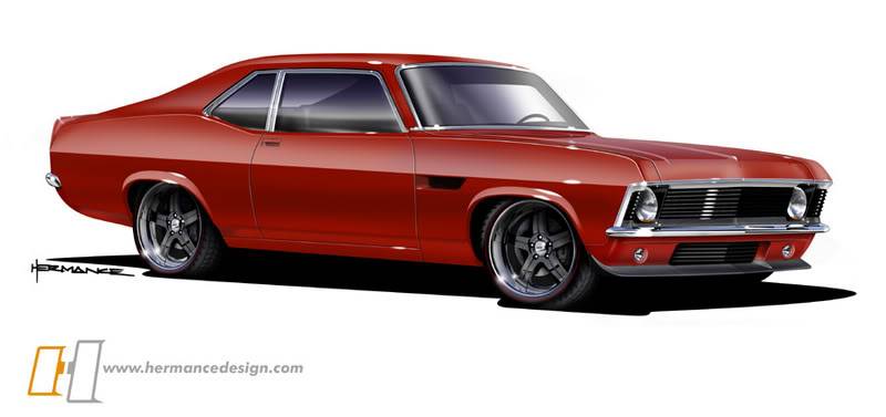

      There are ways to get the lighter bumper effect without simply slapping a Camaro nose on it. The one Brian Stupski is doing (with the 69 nose) will be totally integrated with the fender "swoops" and everything. It's really not the Frankenstein creation some people are thinking.
      I'm taking a different approach by using and modifying the existing bumpers and creating lower valences that match the rest of the body. I love the look of the Novas but the bumpers are just way too chunky for me. The only other mod I'm doing is the rear tail panel and spoiler, though I've contemplated how difficult it would be to graft in the hardtop look, glass and all, from a Camaro while retaining the rest of the Nova roof. Door posts drive me nuts!
      This is pretty much where I've been at for over a year but it needs more work, especially the rear.

      Houston, Tx
      2,200
      hahah Ben we are on the exact same page. I definately want to find a way to make the front bumper look lighter, but I really dont want to put the camaro stuff on there because then I will get the people saying, well why dont you just build a camaro. Anbd the door posts...ahhhh horrible...i did a quick photoshop getting rid of them an all I can say was I guarentee that the nova would have been quite a bit more popular without them...it looks amazing...and I definately like that lower valence, I have been doing numerous designs on my own time (just sketches) trying to figure out how to work the front bumper so that it works with the car, I have not really come up with anything...yours is gonna look great when it is done...have you made much progress with it?

      Jun 2006
      728
      I don't think you necessarily have to put Camaro bumpers on anyway. The Nova bumpers are contoured correctly to wrap around the outer edge of the headlight. You can still use the stock filler piece under the grill if you don't tuck the bumper too far in.
      As far as the posts, I think that is one reason why the Nova is a little lighter than the Camaro. (I'm pretty sure I heard that was the case anyway) The structural pieces that are required to reinforce a hardtop add weight.

    11. #51
      Feb 2006
      SoCal
      1,622
      My .02!
      Look at the '67 Chevelle front bumper! I like how it integrates into the body but has enough width to still make it look like it's not off a camaro.
      The rendering is cool but I think the bumper is a little on the thin side.

      May 2007
      Houston, Tx
      2,200
      Quote Originally Posted by novanutcase
      My .02!
      The rendering is cool but I think the bumper is a little in the thin side.
      John
      good call John, I had not even thought about anything aside from the camaro for some reason, the chevelle bumper is a whole lot smoother than the Nova one, thats for sure...I will definately have to consider this now...thanks bigtime!
