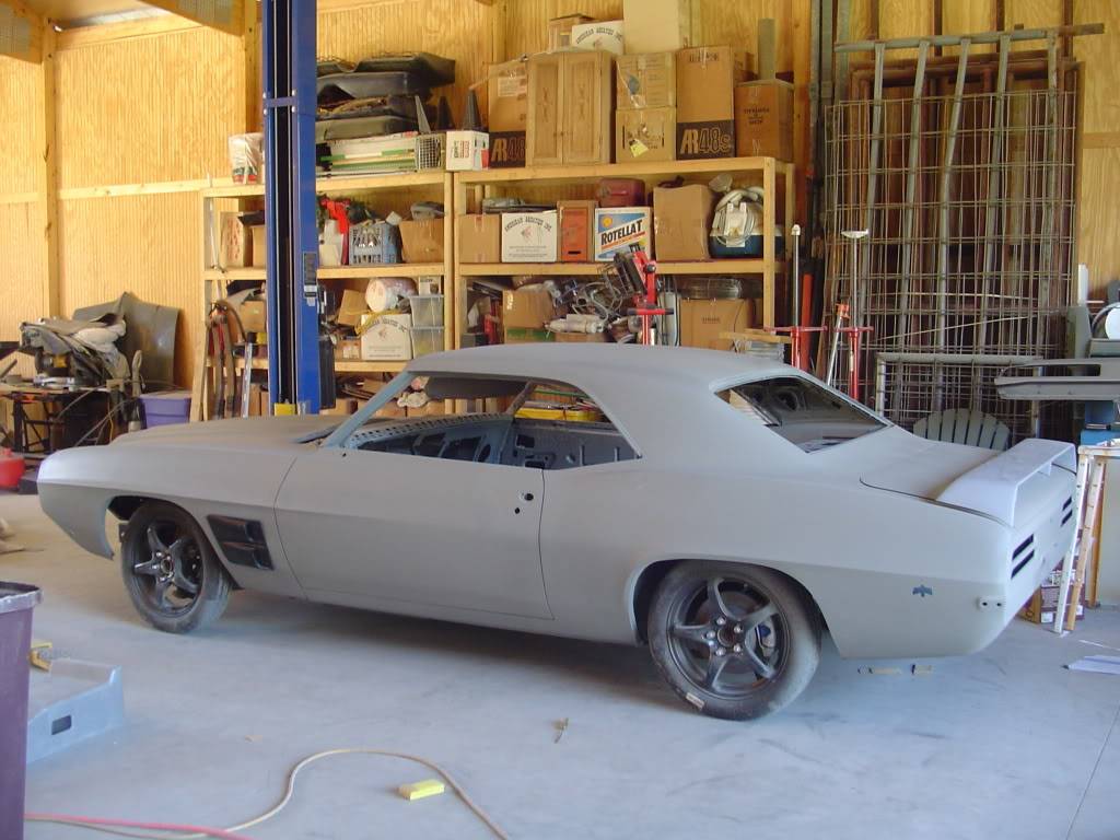

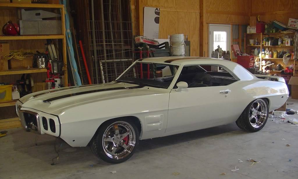

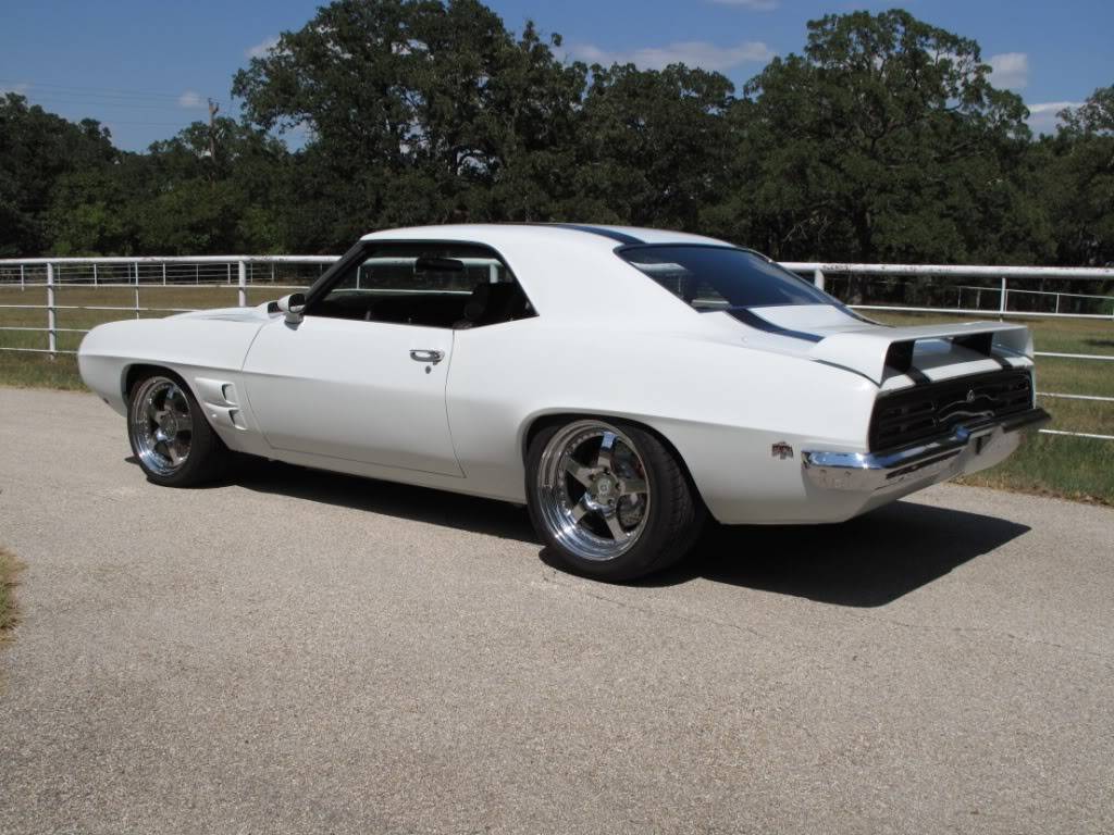

      It's been a year since I posted this and I've made some progress. The car is running and painted. Painting your own car is a very humbling experience. It still needs some wet sanding and buffing but it's not going to be much more than a nice ten footer. Some assembly and the interior to go but hopefully we will be on the road this spring. Just did a test fit on the used HRE wheels that I bought on ebay. Looks like the backspacing was right on. Still have to dial in the stance a little once I get some tires installed in a week or so. Looks like I need the back up a little and the front down a little. Might need to go to 450 pound springs on the front coilovers but I still need to install the Firebird front bumper and grill assembly which is heavier that the Camaro one. The hood is fiberglass so that's not helping much. Here's a picture of where it is today.

      _That_ is a beautiful car!
      Great work.

      When I put the nose on my car, it went from being 1" higher in the front, to 1" lower in the front. I have Hotchkis BBC springs in mine with iron heads. So you can pretty much count on at least 1.5-2" drop with just the nose. It doesn't weigh that much, but it's way out there, so lots of leverage. My battery is in the trunk. I don't have my hood on yet so that didn't affect it either.

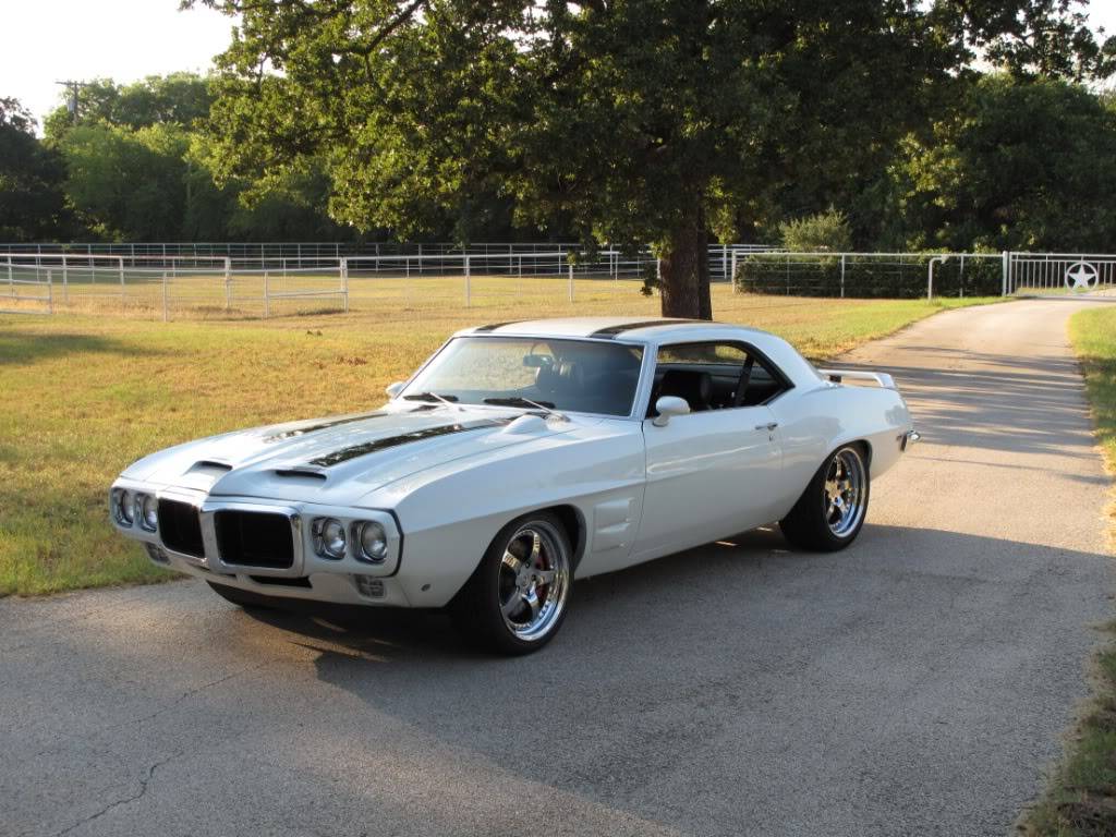

      I've been doing some more assembly. The fiberglass Trans Am hood continues to be a huge POS. The shape of the beak is wrong and I am going to have to give it a nose job. I should have test fit the bumper before I painted it. I went looking at the pics of Empty Nest and found a progress pic where they were doing the same thing to the hood.
      I like the look of the wheels. The front is still a little high, might have to go with 450 pound springs on the coilovers.
      Decided to go with factory deluxe interior door panels to keep the budget under control. I like the look of them in black.

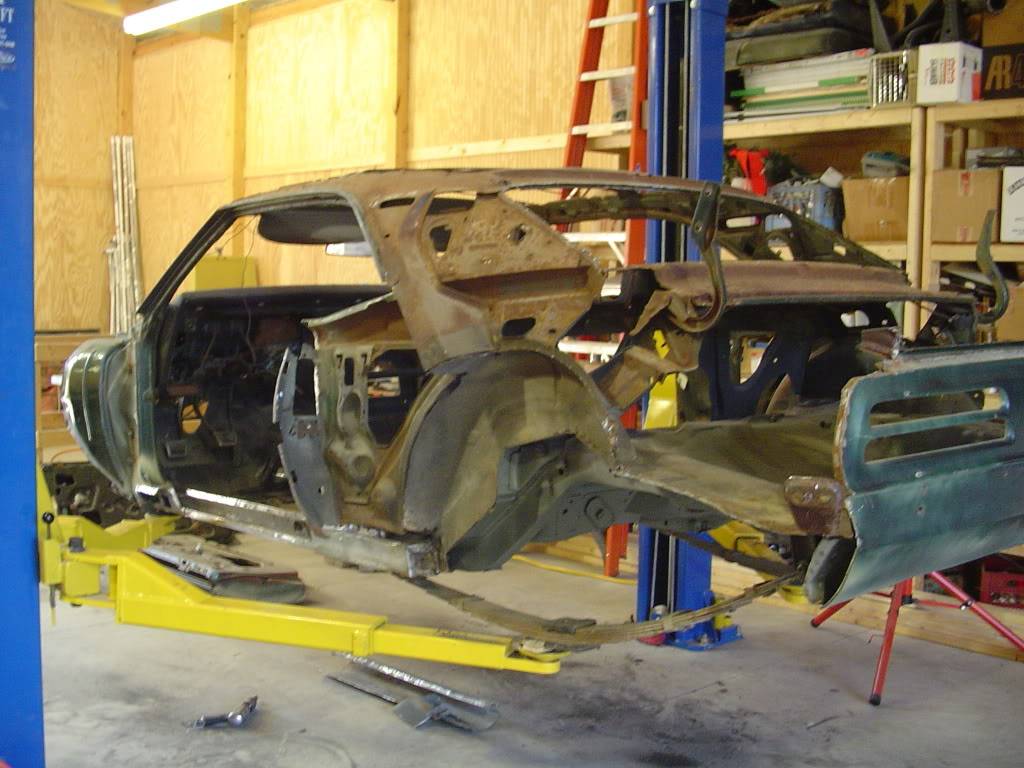

      Thanks guys. Phil, I don't really have too many more pics but I see the original photos were lost in the hack. Here are some before and during shots. No underhood shots yet. It's just a stock LS1 and it's a little dusty. My build is a home shop budget build so there is not much bling under the hood. The most there will probably be is some coil covers. I plan to start on the interior soon.

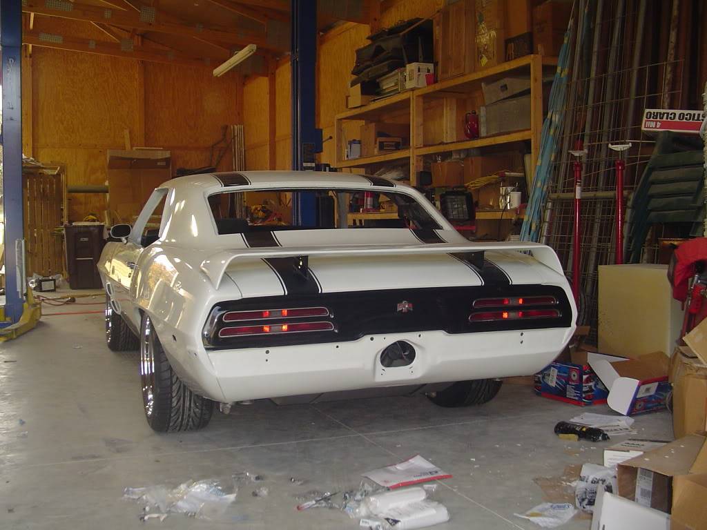

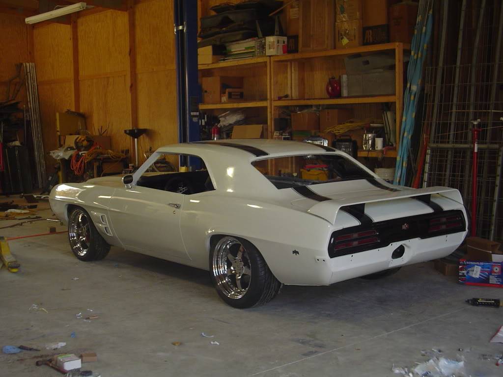

      Had the car out of the shop today. Still a bunch of small things to do but I should have it on the road this fall. I also need to do the front end alignment and install the KRC power steering pump. The front end is a little high so I am going to install some 450 pound springs on the front coilovers before I do the alignment.

      Thanks Sam. I've been following your build and I just wish mine was as nice. Not out on the road yet, just a few short burnouts in the driveway. Hopefully soon, within the next month or so.

      What are your current spring rates now? What coilovers are you using?
