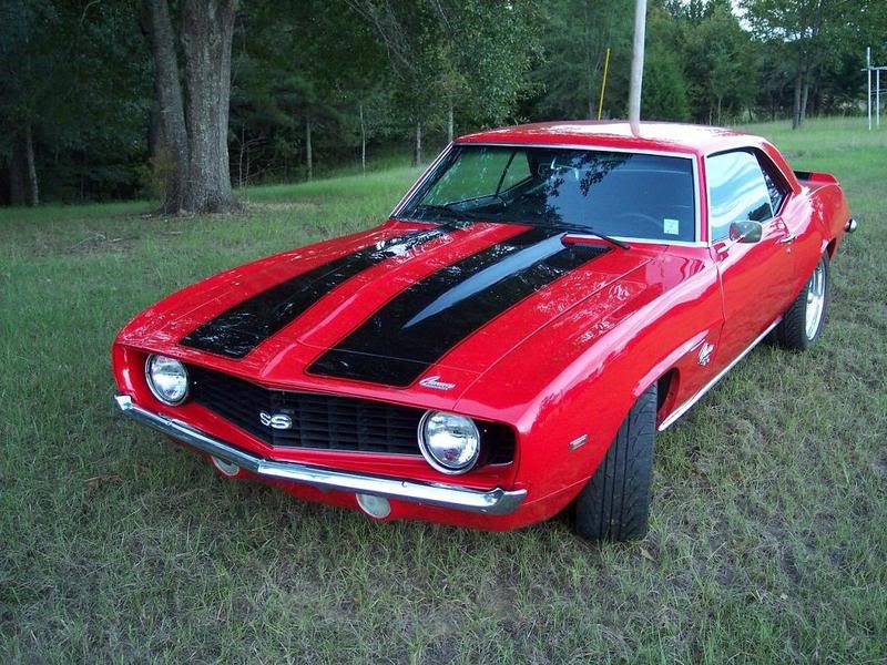

      I had planned to restore a car but after 3 years i still just had a shell. here is my new car before the tear down started.

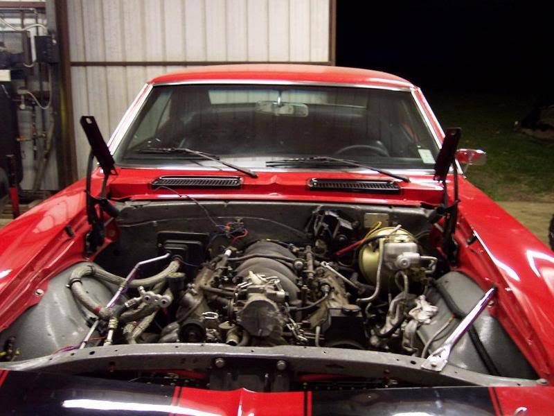

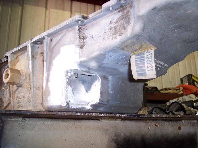

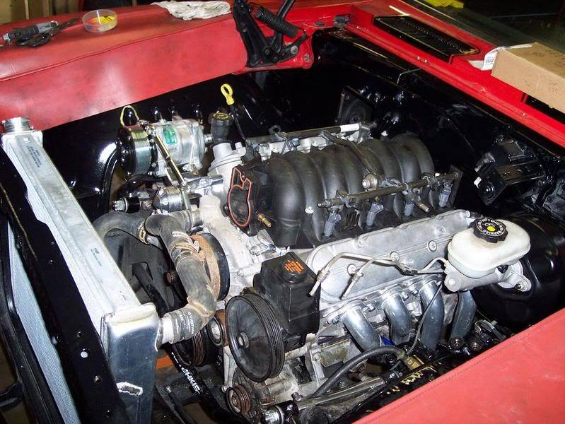

      last week i set the engine in with hooker headers and hooker mounts. it was a tight fit but today i discovered a nice benifit.

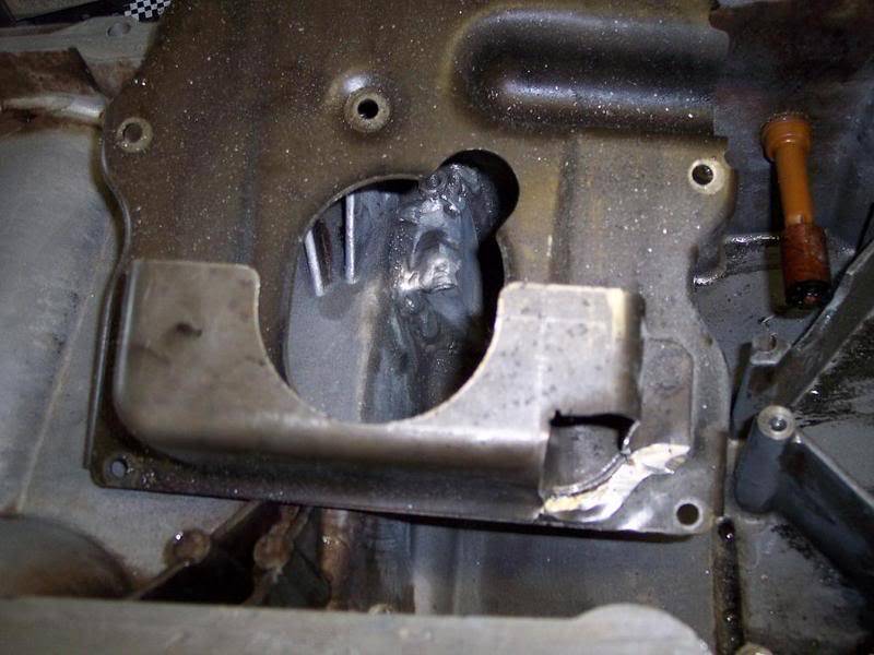

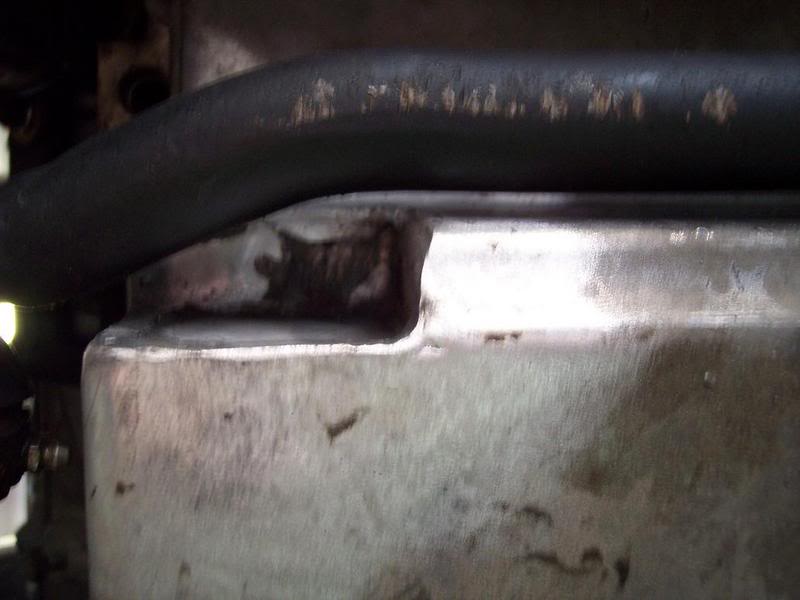

      the benifit is that the stock oil pan will "almost" work. in fact it would but the drag link would hit on a hard right turn. i did not have to modify the oil tube and the OEM baffle has one little mod.

      Good looking project. Is that a Camaro pan?
      Jackson Ms
      1,220
      thanks and yes it is.

      My buddy is doing the same swap, dont know what motor mounts you are using but he used a truck pan w/o any clearance issuse?

      Quote Originally Posted by 68C/10
      My buddy used a truck pan w/o any clearance issuse?
      i hope he does not knock the bottom out of the pan because it hangs low.

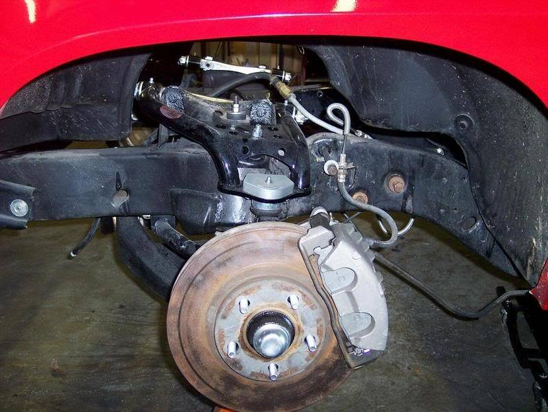

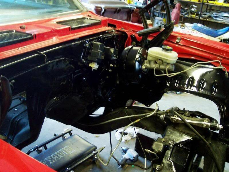

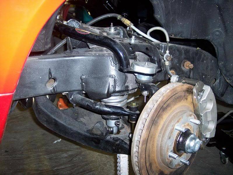

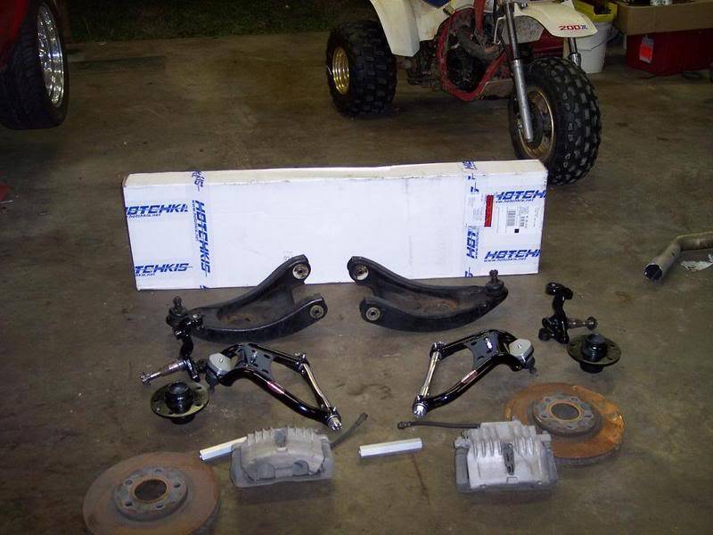

      I got speed tech uppers on and the lowers with DSE bushings. I had to remove one of the lowers to install the sway bar. I still have to mount the brakes.

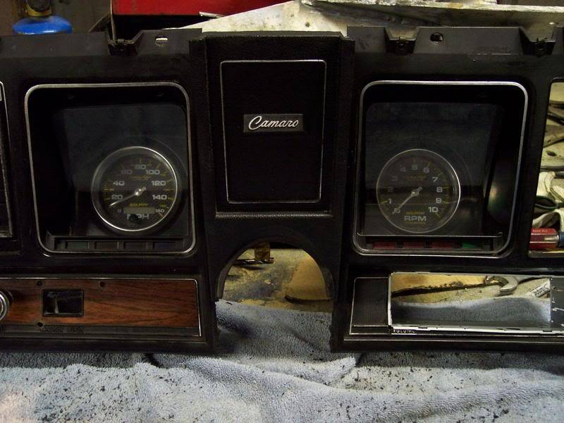

      now here is some bling or not so bling. I am not a big fan of the aftermarket dashes so i am trying to keep it stock looking. I plan to paint the silver rings semi flat. i still have to finish it up but i can see how it will look!!

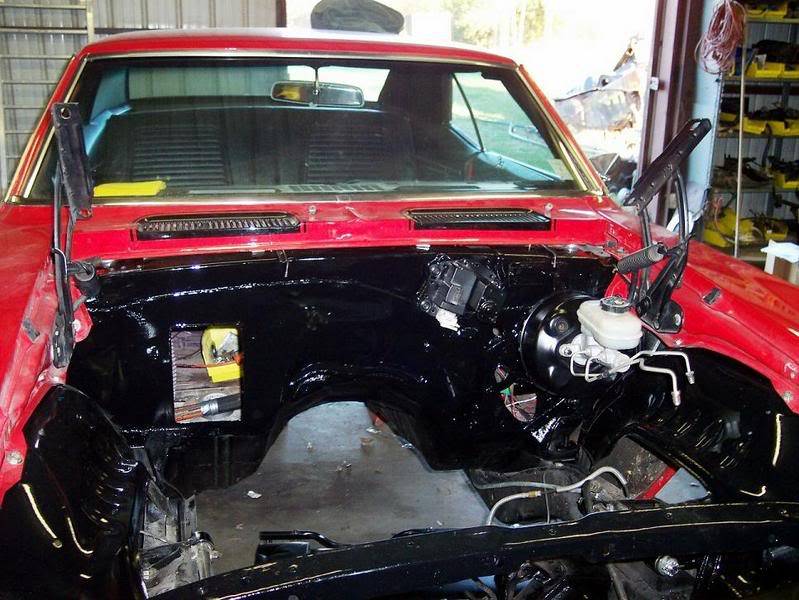

      well i thought i would show off what little progress i have done so far. the hold up is parts!!! I am still waiting on my ricks tank and other parts for the ls1.

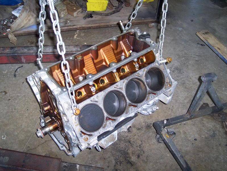

      here is the engine ready to drop off at the machine shop in the morning.
      here are the ls1 brakes, speed tech uppers, lowers with DSE bushings, and new sway bar.

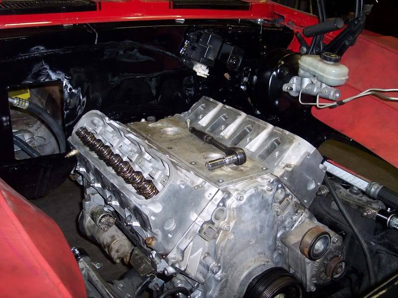

      here is the black and semi smoothed engine bay. it has more gloss then i wanted but way better then the grey that it was before. the LS1 booster and master are installed along with the clutch master.
      here is the dash set into place.

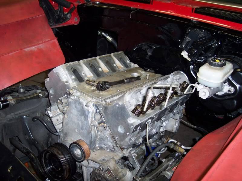

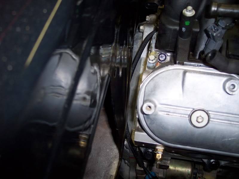

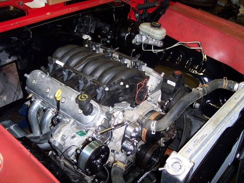

      here is a shot of the engine location with the hooker mounts.
      everyone ask about how close it it. It is CLOSE but it does fit. to make it easier i have the center link out of the steering. I test fit the engine complete but after painting the firewall i decided to put the engine back in and then install the heads.
      engine setting there.

      Looks good, as long as it doesn't touch on hard acceleration you should be ok. Keep the updates coming.

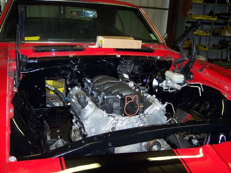

      Jackson Ms
      1,220
      i got ls6 intake installed. I also set the engine to 3* down and there is 7/8" between the firewall and the head.

      radiator hose is for mock up only. I am off to buy a new one now
