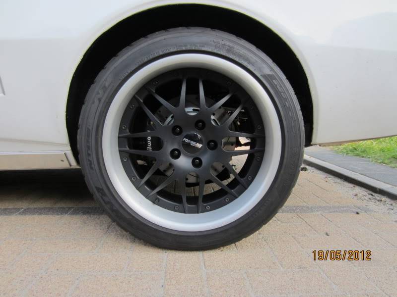

      Cliff, any album with bigger pictures of the bird? Really like the stance!
      Gui

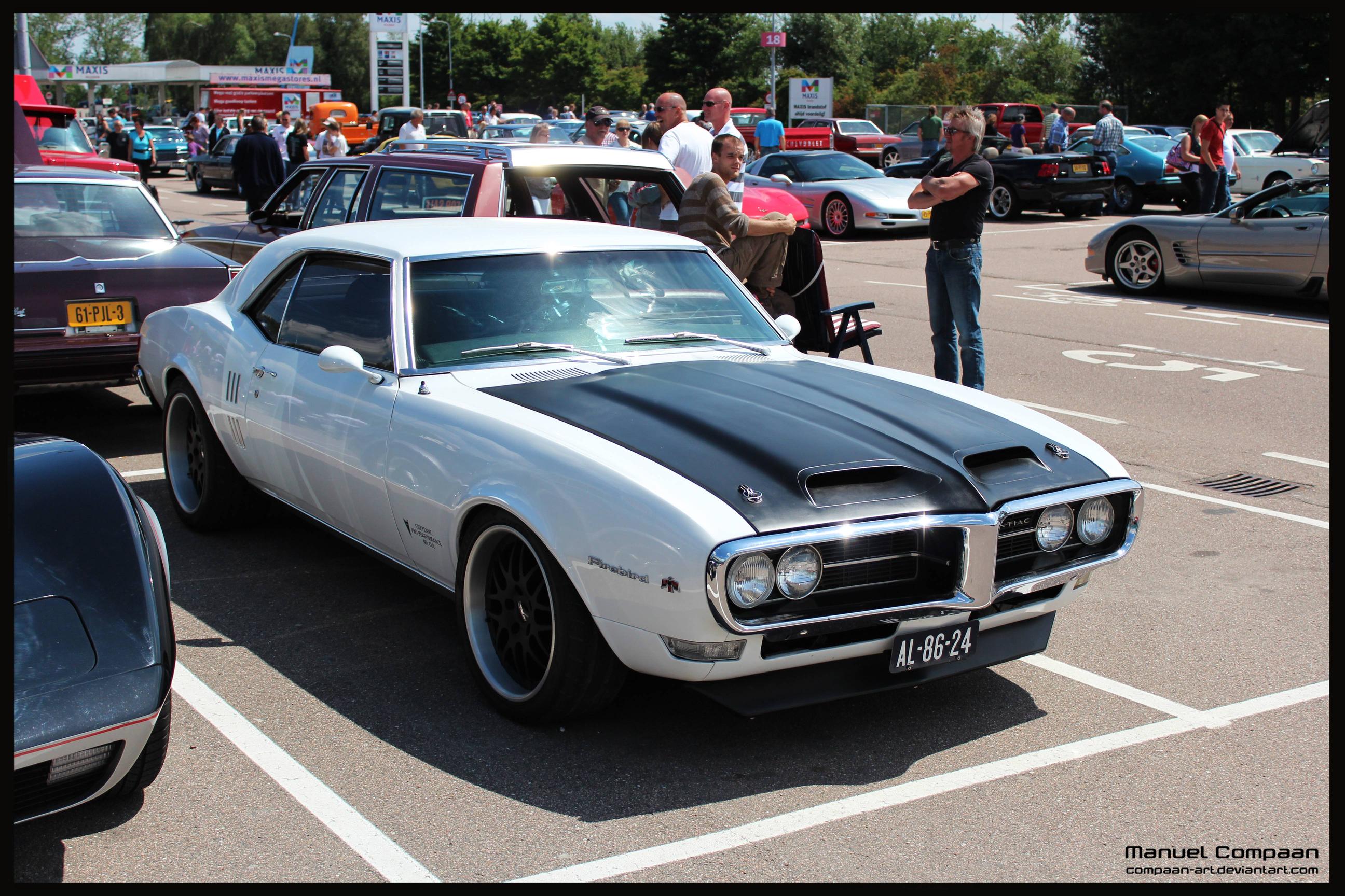

      2 pics of your Bird I made last year
      Very nice car, man! Me and my dad are building a '69 Javelin. In a few years, we are present on this meeting too, haha.

      Thanks for the pics! Pretty rare car in our small country that Javelin, good luck wrenching!!!
      Cliff

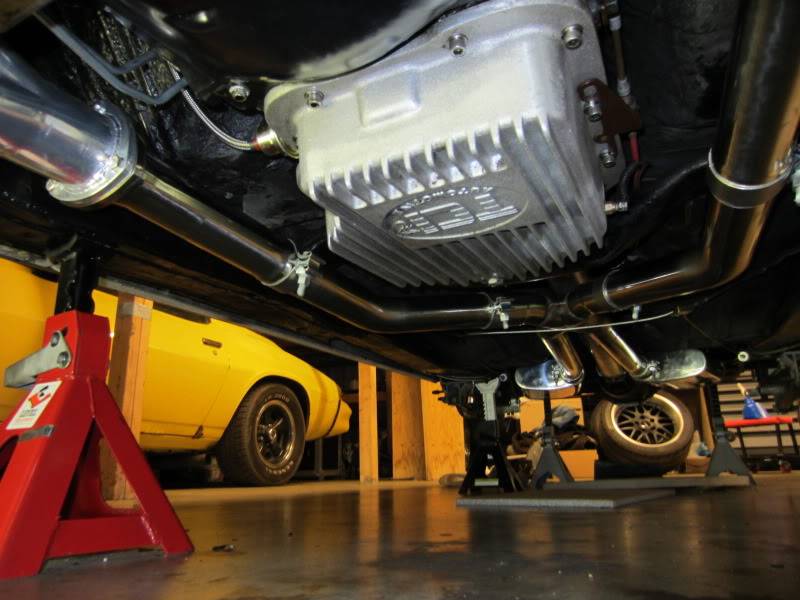

      Been trying to work on the exhaust system. Coated Doug's headers and the Magnaflow kit from Frank.
      Install of the headers was as easy as you can get. The engine didn't had to be lift at all or such. Ground clearance is optimum (old set up with Hooker gave only 3" clearance).
      For all you Poncho guys with first gen Birds; there is a major Oil filter (housing) -to - header - clearance difference between round port and D-port Doug's headers. As also seen on Joe's thread ('67 Re-birth) on this board.
      pics say more...
      Headers installed with 110 dgrs filter housing:
      Tried smaller diameter and shorter oil filters but no difference
      I was able to track down a straight oil filter housing from a '64 engine (right):
      By-pass valve removed an tapped for 3/8 plug
      problem solved:

      Which filter did you go with? NAPA 1258? Also, I've been reading up on that bypass spring in the housing and am undecided on leaving it as is or doing what you did. What are you're thoughts on that? What swayed your decision to block it? I'm having a hard time finding a good reason to go either way, there's solid arguments for both

      Ended up with the 1258 (bigger volume). Since the bypass spring is almost 50 years old and the housing (Kauffman) I've been using for the past couple of years doesn't has the bypass at all and that all oil passing the filter is actually filtered made the decission a lot easier. Not a lot to find about this and opnions differ. Couple of Poncho engines builders also advise to block the bypass.

      Filter done. Next the exhaust; stainless Magnaflow X-pipe. Ordered an extra set of 12" stainless collectors/reducers and had them expanded to exept 2.5"pipe. Angle of the collectors had to be altered because the headers are pretty tight to the floor and not centered in the transmission crossmember.
      mock up and ready for welding
