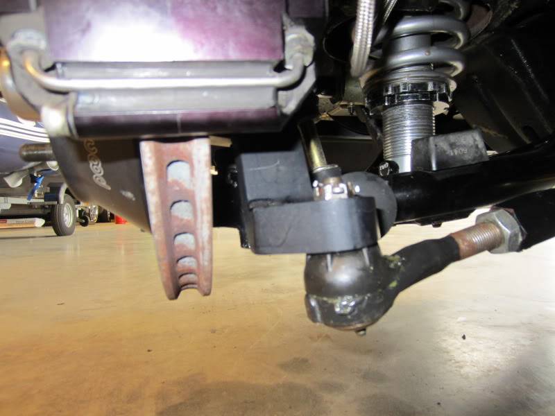

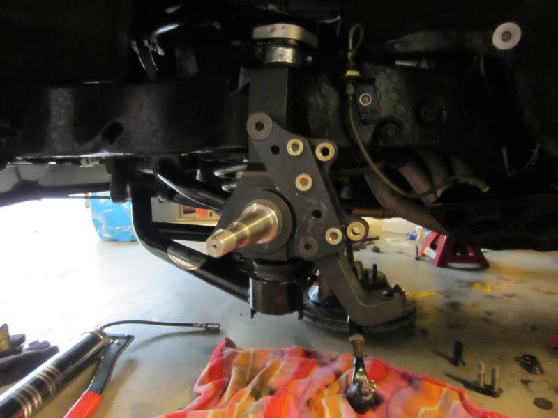

      Got my bolts fom L&H and bolted the bracket and Wilwood stuff
      Closer look on steering arms after mock up

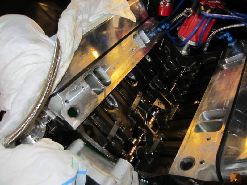

      yesterday evening a valley pan swap
      internals were looking good

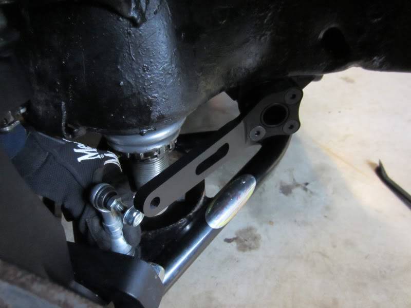

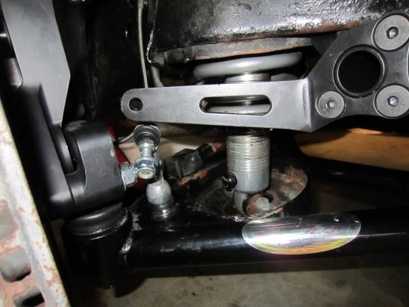

      Just installed the ridetech Muscle Bar. I will have to relocate the Posi links to clear the Steering arm
      @ Darren @ ridetech; thanks for the awesome support & service!
