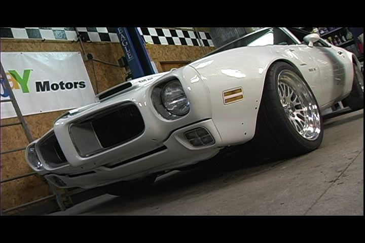

      I've got to put in a vote for CCW also. John is very helpful, and for a wheel you're going to go and abuse, you can't beat the price. You can check out this video http://v8tvshow.com/content/view/337/78/ and at the end you can see the Classics going on in the front. Here are my offset's the fronts clear all suspension components. The rear's are custom, I've mini tubbed the car and cut the rear end to the length I wanted to get a deeper dish wheel.
      18x9.5 with 5.25” back spacing CCW fronts Toyo RA1 (275/35/18) 25.6” tall
      18X12 with 4” back spacing CCW rears Toyo RA1 (335/30/18) 25.9” tall

      Yeah, they really look great! The more I look at them, the better they look.
      2genracer; Thanks for your measurements, allthough I will build my own front and rear suspension, so I'll use other back spacing#.
      Do you have any pictures with both front and rear wheels mounted? Also, where did you buy your tires?
