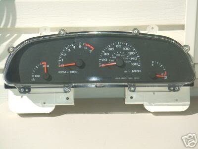

      I want to build a dash will fit in my 1967 Chevelle.... Not round gauges in an rectangle opening.... but more like my old 96 Impala SS ... One flat peice of metal with all the gauges screen printed on the front and all the gauges mounted behind ... and it has to fit in the stock dash ... and look like it could have been there from the beginning.... this is just an example ... I would want few more readings... oil pressure, volts etc....
      I will eventually be running an LS2 or maybe an LS3 so they would have to tie into the ECM somehow too . . . .

      Got it; http://www.plasmatacho.de/ , look under tachoscheiben. They can do custom designs for you or you can bring in your own design. Mind you, these plates, once connected, light up themselves (blue, green, red, etc.), so you don't need backlighting.
      If you need some translation, feel free to contact me.
      Just to give you some ideas:
