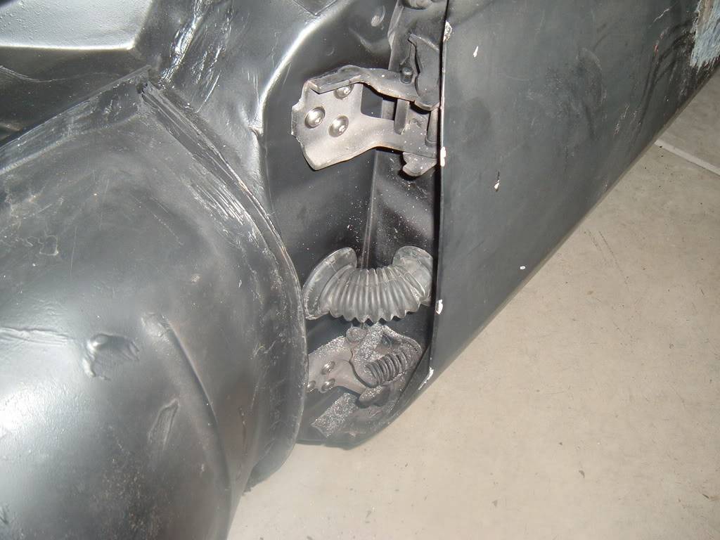

      Is there a way to cleanly run wires into the doors on a 69 Camaro without removing the fenders?
      Also are there some OEM looking boots available anywhere?

      the wiring boots I have used in the past are from the 80's chevy truck.
      They are easy to find in any U-Pull It yard and work like a charm.

      You can drill the door side hole from inside the door, just make sure the drill does not grab and twist denting the door. The door frame side is straight forward. The hot set up is braided tubes from Electric Life.

      2002 camaro, you'll need a 2 3/4 hole saw and a 1 3/4 hole saw. go to the junk yard and get them.

      A little smaller and very nice looking, not to mention easy to get, are the boots from a '90s GM W body. That's the Pontiac Bonneville, Olds 88, etc.
