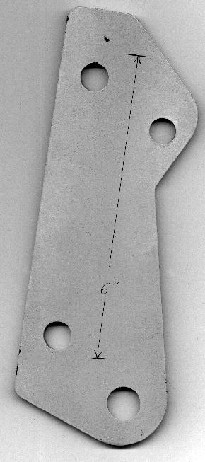

      I used the bracket template and it worked out great. Heres some pics;

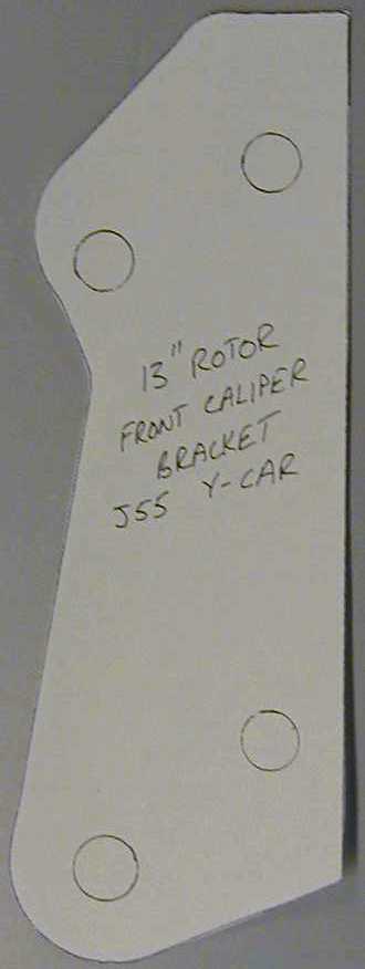

      This template is for first gen. Anyone having 2-gen brakets and kan draw a line around them on a paper... Or a link to a template....
      Olav

      Olav,
      If you decide to go the LS1 route I do have templetes drawn up for them. I think I even have a .jpg of them at home. Only issue is that they are really tight; the caliper bracket bolts are tricky to get in. Not a greate angle, but this thread has a pic of what mine look like: https://www.pro-touring.com/forum/sh...ighlight=skunk

      Hmm, the calipers are interchangable I believe, but the C5 caliper bracket uses 14mm bolts, where as the LS setup uses 12mm. Not sure of the spacing between bolt holes. Mine is not fancy or pretty, but it works. I a strip of 2" wide 1/4' steel for the bracket.
      Don't the washers give it a custom look?
      I found my templete, but looks like the mice got to it a bit. Here are the dementions:
      5" between caliper bracket holes
      7 5/8" between spindle holes
      The two holes for the caliper bracket were centered between the spindle holes and 11/32" below them.
      Makes a bit more sense if you look at the photos above. BTW, I drilled out and retapped my spindle mounting holes. Can't remember, but think I resized them to 7/16". Hope that helps.
      Brent

      Took the measurements they are the same. If I make them of steel I have to mill them to get them as light as possible. Don,t like alu for these parts. Are your rotors 13" ?

      No, the LS1 rotors are 12". If the measurements on the basket are the same, just drill and tap the holes to 14mm instead of 12mm and raise their location 1/2". Actually, I think that extra 1/2" will make it a much easier fit than the LS1 setup. It was real difficult to get my big mits in there, felt like I was working on an import!

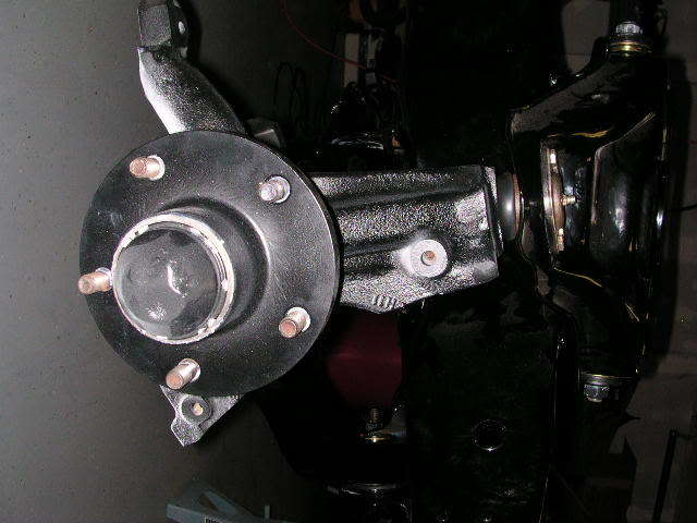

      Are you buying aftermarket hubs or just cutting off your stock discs to make a hub? I did the latter and it came you nice.
      Brent
      Phoenix,Arizona
      1,013
      I used front drum hubs, just machined down slightly. Works great too.

      Found a picture on kore3 site and did some measurements. Found that I had to raise the holes. I will make my own hubs when I get a used pair of 3-gen brake rotors.Did you use 2-gen rotors ? They are hard to find in Norway and new one costs about $100 each here. I work as a mechanichal supervisor in a ship yard so machining is no problem.
