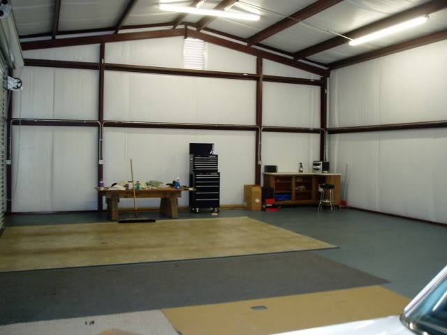

      Here is what I did to cover up my crappy floor for a little bt. I purchased two pretty big vinyl mats and some carpet for where the door is. It works ok for now but still show a few of the problem areas.
      Andrew Petty
