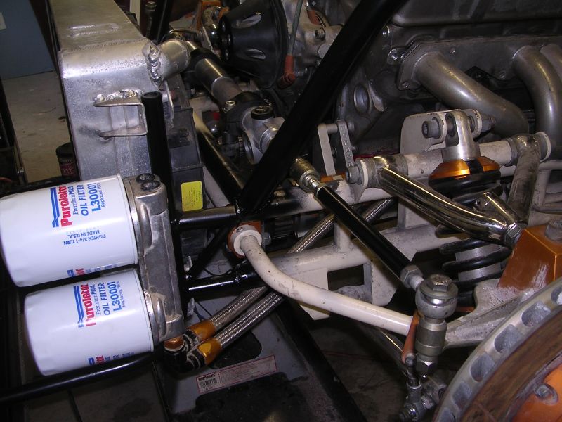

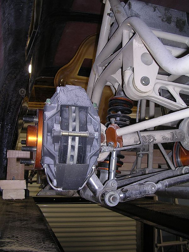

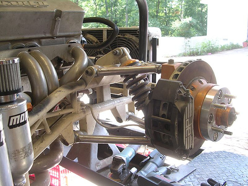

      To be honest I thought the car was quite crude, so I decided to build a hot rod that would be faster around the track than the '40. That meant stiffer chassis made from round-tube, AP racing brakes (F1 front, F3000 rear), 10pt cage, multi-link IRS, IFS and lots more power from a 8000rpm, dry-sumped 383 sbc. I even sprung for some air-jacks (I was young and between wives at the time )
      Anyway, the short story; I had a minor crash at the track, it went into storage, I got married, emigrated to the US, changed jobs and had 3 kids. That took 10 years!

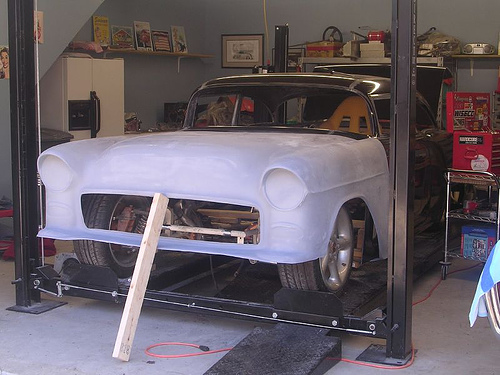

      Last November I get it out of storage and start work on it again. This time I wanted a 55 chevy body (same wheelbase as the chassis and have you SEEN two lane blacktop? ) so I bought a 'glass body without floor and started modifiying to suit. New rollcage, steering (was RHD in England, now obviously I want LHD in Atlanta) and new oil tank, radator, catch tanks etc (ruined in the crash).

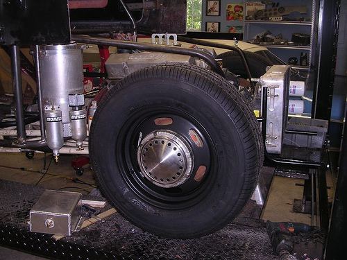

      Now my wheels will be a problem with some on here I'm sure. I needed to choose new wheels cos the 55 was wider than my old body. And I just couldnt get the 18's that I was using to look right under the (very) low 55. They look plain *wrong*.
      My thoughts:
      1. my chassis is very stiffly sprung and low - great for track, not so much for 20k+ miles a year street miles
      2. new wheels (e.g bbs) was going to cost me a small fortune - and that well's dried up folks
      3. I'm a big fan of traditional hot rods - in looks at least.
      So I made a radical choice that I love (and ain't I the only one that counts?!!) - widened mopar cop steel wheels and 70's series tires.
      *stunned silence*
      hehe. Yeah, well. So I have a race car that basically looks like a '55 running on pro-street hoosiers and 70's series eagles. I love the look, the sidewalls will sure cut down on track cornering but the car is built to kick-ass on the street now. Trust me it'll still outrun most posers around the bends. Who knows, if I find a pot of gold I'll buy a set of track wheels for Road Atlanta.
