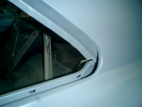

      Here you go JP, keep in mind it's still a work in progress....
      Ryan

      Ryan,
      That's perfect! Exactly what I was looking for. Looks great, btw.
      More questions: where can I learn more about street rodder window fuzzies? Did you weld to fill the gaps, or use body filler?
      thanks!
      jp

      First, my body shop did the work, so I can't take credit for it... other than paying them..... Yes, the seams were welded, and filler was only used to clean it up. The fuzzies are "universal" types and come in 8' sticks, so you have to cut them to fit your application. I'll look around and see if I can find you a link to some.
