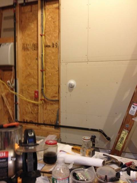

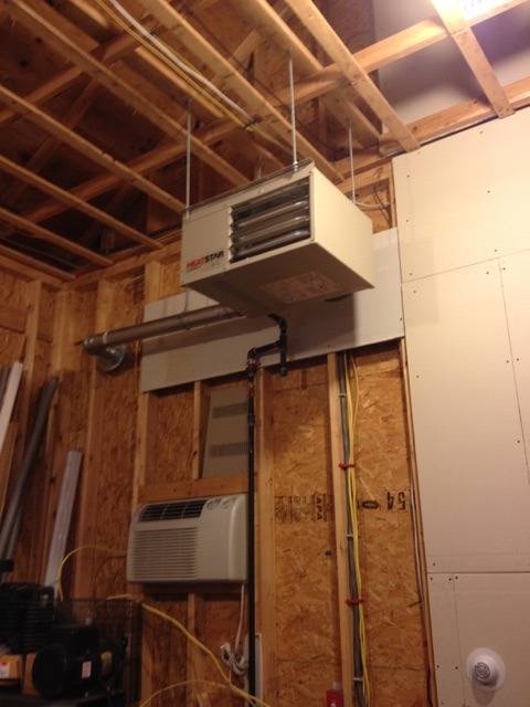

      Today I was working on the wiring for the Big MAXX garage heater. I really need to clean this place up! At work I always told my guys make it safe!!! Today I'm hanging from the trusses and standing on the pump from my 80 gal compressor to get the wires run. I kept looking over my shoulder for the safetyman, but the wires are run just need to tie it in to the heater and run the thermostat and it will be ready for the plumbers to run the gas pipe Monday. They ran the vent out the wall Friday and said they would finish Monday, They must have known I wanted it done then because they brought my about a quarter bushel of clams and little necks. So I did the only thing I could I made a clam boil for me the wife and my daughters family. Brownie points for me ;)

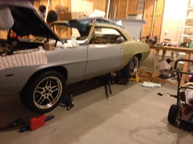

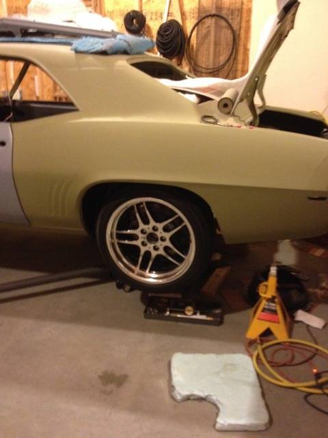

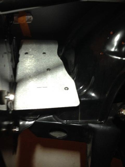

      We've been working on the car a few hours a day we installed the RS doors to figure if it would interfere with the intercooler reservoir. I'm going to put it right behind the passenger headlight in the same place Travis (Snappytravis) put his. I had been thinking about putting it there and seeing how nice his is, it was definitely a go.
      We made a platform to mount the tank out of aluminum and bolted it in to see how it fit .It will have a piece in the back for a tab to slide into and be bolted 2 or 3 places in the front and be covered with some type of rubber to prevent chafing the tank.
      Here's a quick shot of the platform test fit.

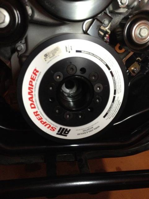

      We removed the factory balancer and are replacing it with an ATI super dampener. If you guys want a Harmonic dampener check out ATI blems on E Bay,for all types of engines you just need to be patient. Instead of the $465 I got one for $269 for my LSA, it doesn't come with the super charger pulley blem or not. If I had to find the blem on it to save my life the wife could sell the car because I would never find it........ The bolt came right out with my impact wrench.

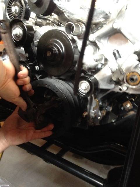

      The problem was getting t he balancer off. We tried with a 3 jaw puller we had, no dice, then I went for an AutoZone loaner, wrong one back again, Then we got another one from AutoZone and it finally got it to move. About 3/16 of an inch, we had to go back to the first puller to finish taking it off, but the loaner was the only thing to get it to break loose.
      And finally in place ready to be put on.

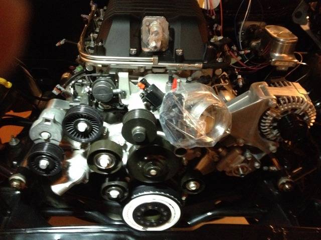

      We also tried the Front accessory drive on for fit. I don't have the A/C compressor yet so that test will have to wait. The throttle body is a ported one from V Max in Florida.
      And something else that will help the build continue.
      HEAT!
      No more frost bite on this old bootie!

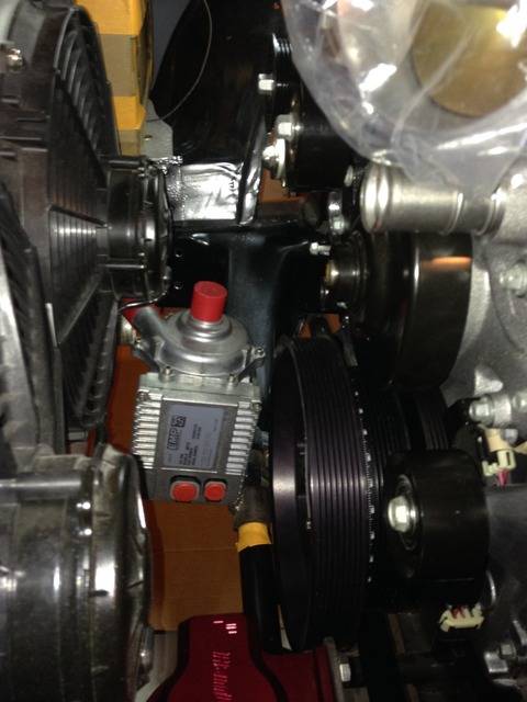

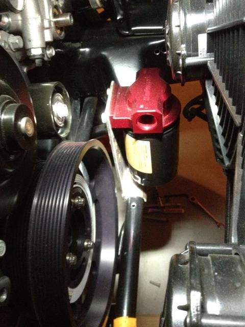

      Yesterday we tried to mount the intercooler pump but it didn't work out too well, the hose that goes to the heat exchanger was going to interfere with the radiator so we're moving the bracket.
      We installed the Hamburger remote oil filter mount on the frame right behind the radiator. I will be running the -12 oil lines to the filter then to the oil cooler in radiator and back after I make my order for my hose and fitting, soon I hope.
      The next thing to try and stuff in there is the trans cooler in the white box in the bottom of the picture.

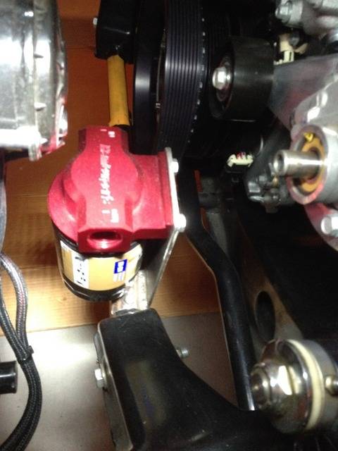

      Not much progress this week, we had to move the remote oil filter because of my mistake. The fitting for the oil cooler stuck out further than I remembered and the mount had no room for the fitting. we made a bracket to mount it on the front bar Mike installed to replace the smaller front cross member on the sub frame, then made a bracket for the intercooler pump. I have no welder so everything has to go to Spaceman's house to be welded.There's more room than appears to be.
      (Heavy little sucker)
      The remote oil filter from here
      To here.
      Brackets will be cleaned up and either painted or powder coated.
