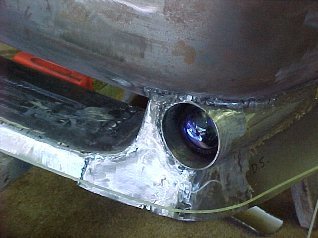

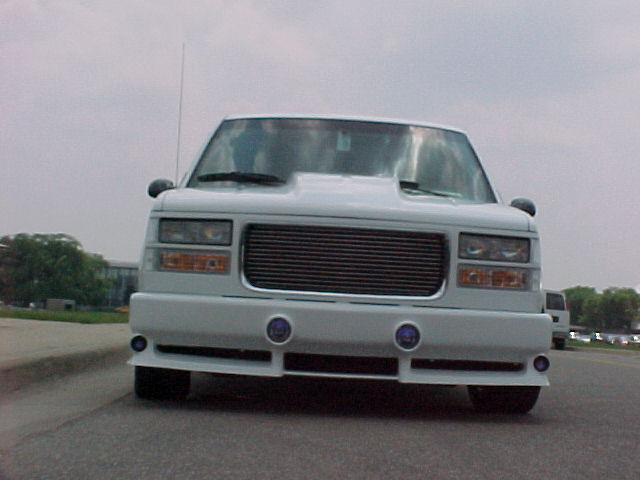

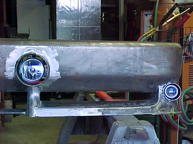

      When I built the front bumper/airdam for my truck I used 5" dia. exhaust tubing for the inner driving light tunnels. The outers are 3" dia exhaust tubing and I built the airdam out of 16ga sheet metal...
      I don't have any pics here at work so I'll post one up tonight...
