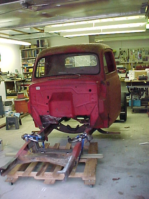

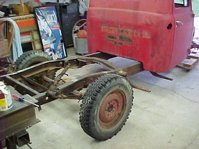

      I got some pics after getting the ford home Tuesday nite and I know ALL of you guys are chomping at the bit to see these...
      The only thing attached to the frame is the cab and the upper control arms... We strapped a pallet (with casters) to the front frame so we could pull it up onto the roll back to get it home.
      we stuck the stock rear suspension back on with one bolt in each hanger so we could move it.
      The TCI front suspension and rear leafs should make this dude ride like a car...
      I ordered an Eastwood chassis black paint kit this morning and will start getting the frame ready by removing the cab and running board brackets.
      I need to get the motor and trans mounts mocked up but that's pretty straight forward and won't take long to do.
      Thanks for looking
      Mark

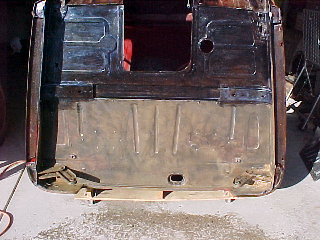

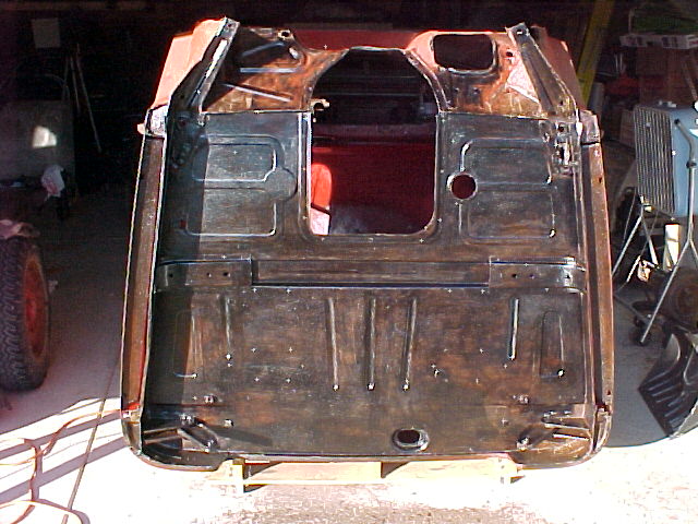

      Just a bit of an update. Haven't gotten a lot done on the truck other then stripping down the donor truck and getting the underside of the floors cleaned up, rust converted and painted.
      I used the Eastwood two part Rust Converter and was impressed with the ease of use and the job it did on what surface rust was left after I power wire brushed the floors.
      This first photo was taken after I had done the upper half with the wire brush. I used a knotted wire cup srtyle brush mounted on one of my angle grinders. Wicked...
      After coating the top half...
      With all of the floor done, I waited about an hour and then sprayed the floor with some cheap red enamel I found at Big Lots... Yea, I know it's not show quality but it will do the job to protect the floors and is much better then what I had...
      Thanks for looking.
      Mark
