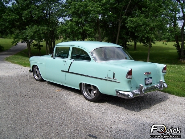

      pic
      here ya go !!

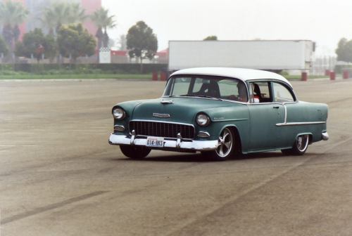

      St.Anne Il
      3,924
      another

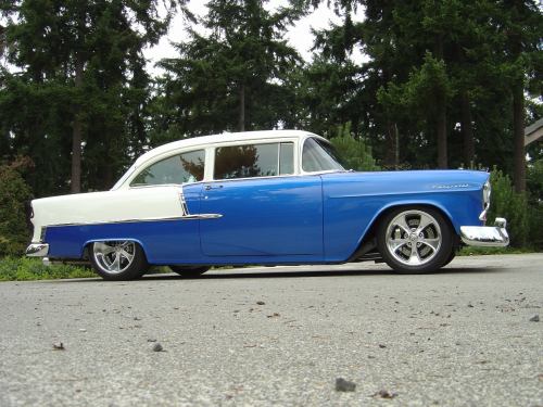

      Eric- That's the way we have designed this chassis, so nothing hangs below the crossmembers (through frame exhaust). Here are a couple pics of our 55 with our "off the shelf" chassis.
      There are 4.5" of ground clearence under the frame by front fender/front door jam area, and with 7200 miles on the car there have only been a few bottom out times.
