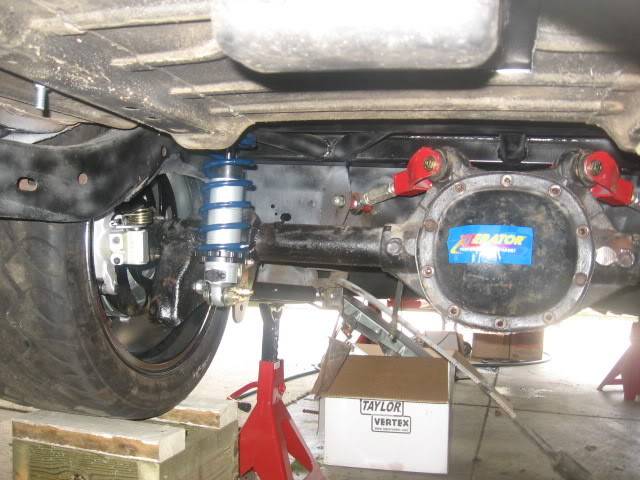

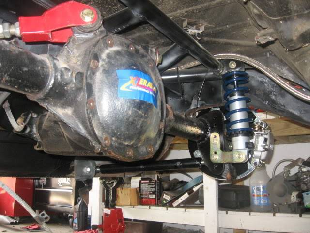

      The center bar looks like it could hit the top of the differential on a rough bump...

      Tony, It looks close but there is about 6 inch's of clearance.

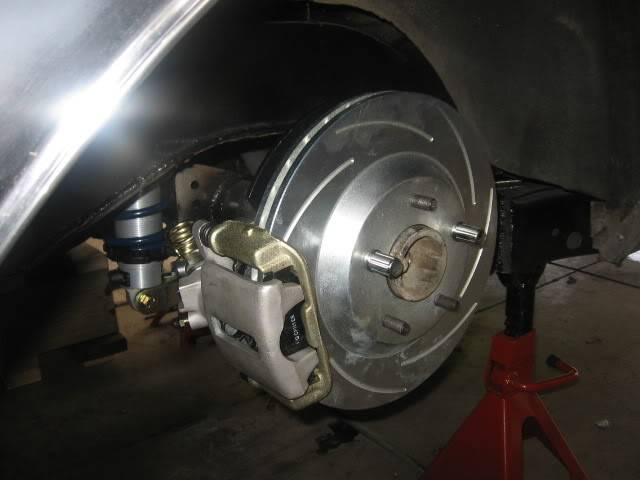

      I received an I M yesterday asking what the setup was.
      I am running double adjustable upper control arms from Ebay as well as double adjustable lower control arms from Ebay. I cut out the orig spring pockets off the frame and put in my own crossmember and bracing. I made the coilover brackets for the axle out of 1/4" steel and welded them on. The Coilovers are from Strange with 200lb Hypercoil Springs. I really like them. The brakes are from SSBC and are ment for a 12 bolt from an A-body, but I made them fit.

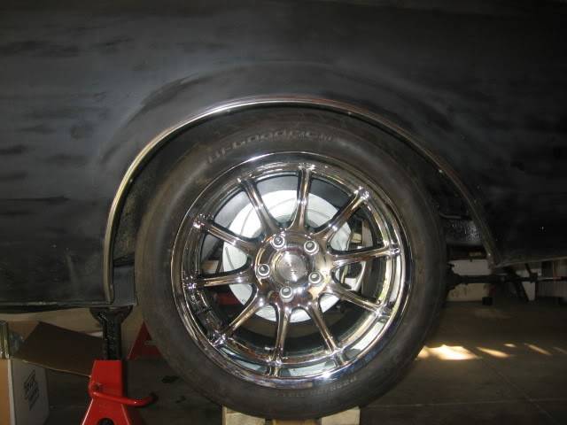

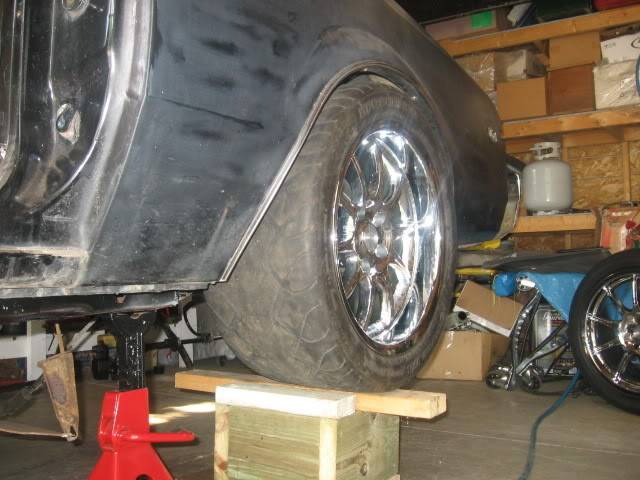

      How about a 3/4 view of the rear wheel, so we can gauge the tire width compared to the quarter panel??What size wheels and tires are they.I love the fab work, looks killer.Keep the pics and info flowing!!

      The Wheel is not bolted to the axle at the moment, it will sit about 1/2" further in. The size is 295/35/18.
      I am going to remove the chrome trim and roll the quarter a little bit so I can get it to tuck just a little bit. I should have that done within the next couple weeks.
