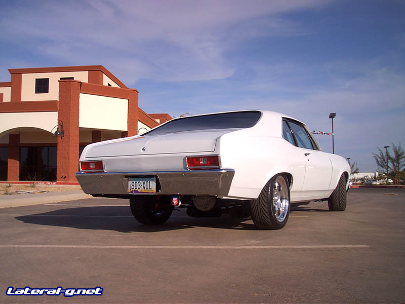

      My bros. Nova is Finally done!!!!
      My bros. Nova is finally done!!!
      Phoenix,Arizona
      1,013
      It only took like 3 years and $25000!!!..........Oh well, I think it was worth it.
      Walla Walla, WA
      260
      looks really nice!

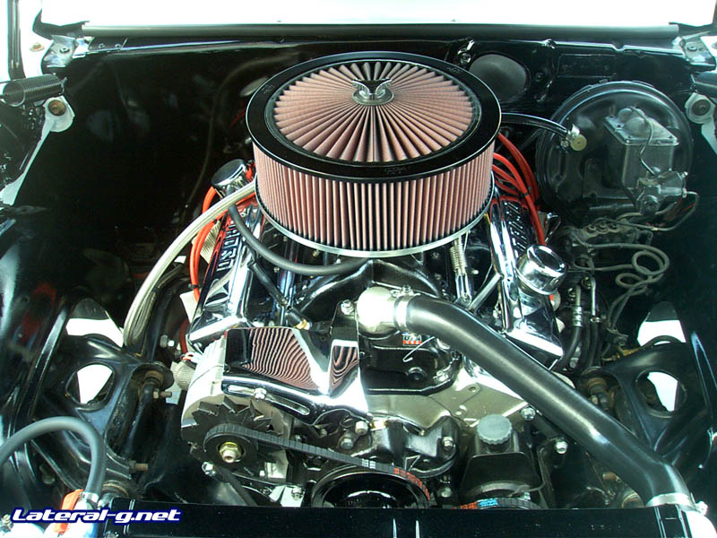

      SWEET! What are the specs of the drivetrain?
      Phoenix,Arizona
      1,013
      Engine:
      -Small Block Chevy; 355cid (4-bolt mains)
      -10.5:1 compression
      -Cast iron cylinder heads;
      -fully ported intake and exhaust
      -polished chambers
      -2.02 /1.60 Milodon stainless steel valves
      -Comp Cams valve springs
      -hardened pushrods w/ guide plates
      -Summit aluminum 1.5 full roller rocker arms
      -Summit stud girdles
      -Isky Cam; .485 valve lift, 232 actual duration(advanced 4 degrees)
      -Pete Jackson gear drive
      -Edelbrock 650cfm carburetor
      -Edelbrock Performer RPM Air-Gap intake manifold (gasket matched)
      -MSD distributor, Blaster 2 coil, 6AL, superconductor wires
      -Accel U-groove spark plugs(.040)
      -Edelbrock Victor aluminum water pump (180)
      -Forged I-beam connecting rods
      -Forged flat-top Keith Black pistons
      -Factory forged crankshaft
      -Moroso 7qt. Oil pan w/ oil baffle
      -Moroso high pressure oil pump and driveshaft
      -Aluminum 2-core radiator
      -Flex-a-lite dual electric cooling fans
      -rotating assembly balanced and blue-printed
      *Estimated output 400-450 HP&TQ.
