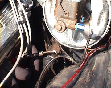

      Monzaracer....I hear your story...but it doesn't make sense to me.... the failure could also happen on a short lenght (from wheel to hard line) and cause it.
      I have never heard of the ss braided lines failing (but I understand it can happen), we used to make and install them on each bike we did when I worked in a bike shop...from caliper to MC. It improves the brake feel over rubber lines too.
      Knowing all that I decided to put full braided lines (goodridge) on my Camaro a few years ago. I drove it on the streets (daily) and never had any problems, recently inspected them since my car is apart and they still look okay. One thing I did was choose the "carbon fibre" look which basically means the braiding is covered with a plastic black translucent jacket same as used on battery cables used in stereo installs. This prevents the braiding from chafing paint or other parts.

      Monzaracer, I hear what you are saying...I live in the Netherlands and the DOT is not a concern for me neither are big lawsuits (not that I ever would want my brakes to fail which is more important).
      How do you think about using the braided line for the short bits, from hard line to caliper?
      My view on it is this:
      the point where braided might fail (if installed unproperly) is at the couplings, not the hose itself.
      When running braided throughout the whole car the number of couplings are equal to just using the hardlines + the last part braided hose so the chances on failure are equal too.
      I had my lines made at Goodridge, I don't live too far from them and I had them pressed on the hose.
