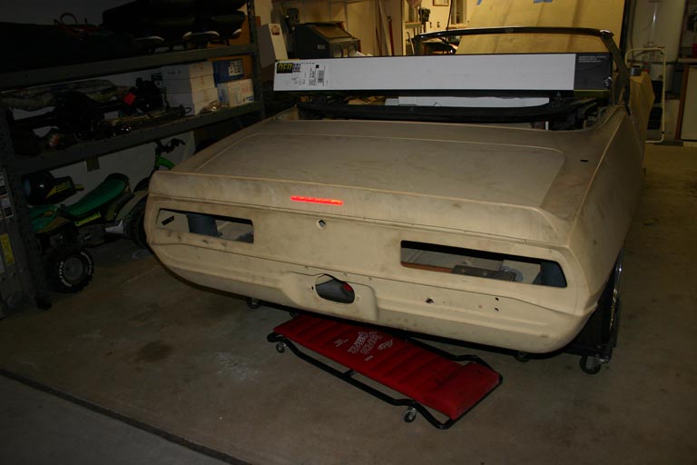

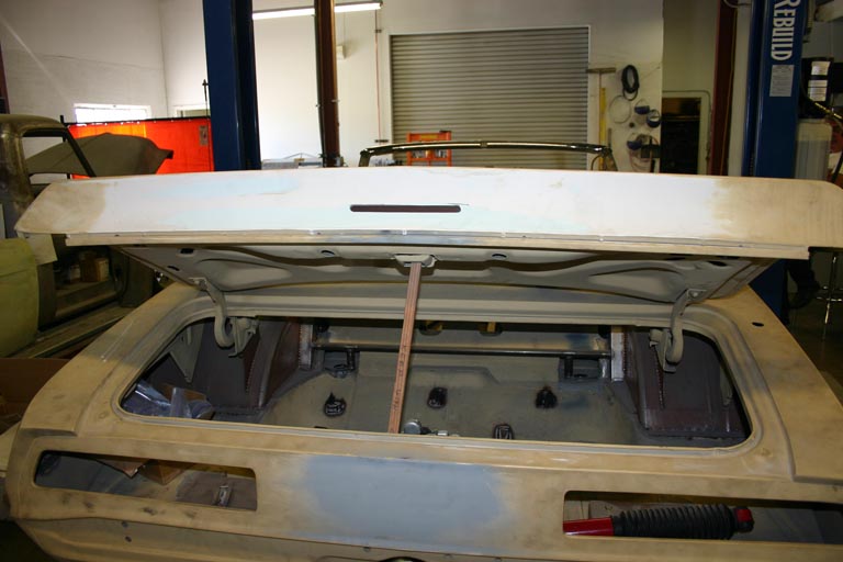

      Watson Streetworks LED Lights
      I also wanted to add a 3roiler (69 Camaro). I ended up purchasing an LED light from Watson Streetworks a couple of years ago (car still under construction). They have several choices, including billet frames:
      http://www.watsons-streetworks.com/leds_plus.html
      The Light I picked (Part #L58SMB) is designed to mount from behind and to be sanded smooth with the body and eventually clear-coated over. Since I am painting the car red, it is my hope that the light (when not lit) will blend in with the body.
      Here's a picture after the initial install...
      Here's a shot after being sanded smooth with the body...
      ---Eric
