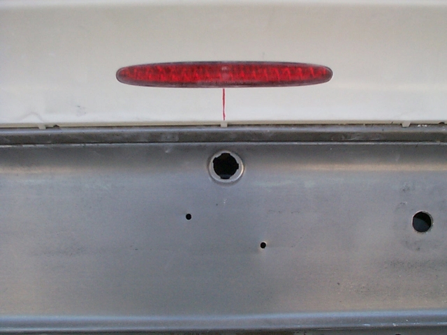

      Here's a couple pix of mine with a 2001 Cavalier light. It's very small in depth, so no dimpling of the deck lid was needed. It fit flush with the inside of the spoiler so I just ran the screws into a couple of clips to mount it.

      that looks real nice. I may put mine in the panel between the glass and trunk.
