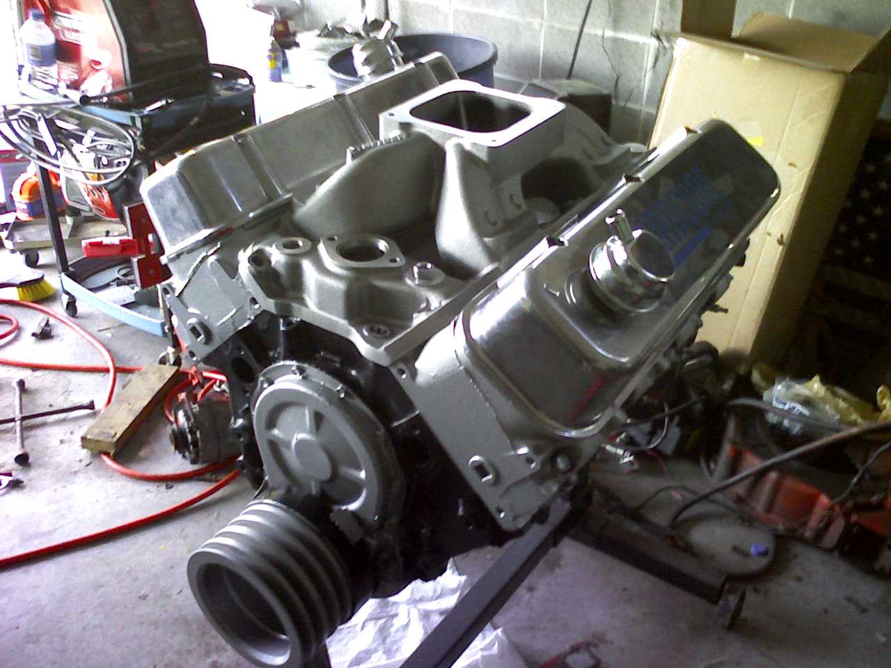

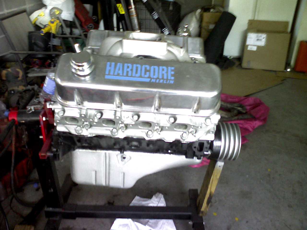

      I am putting a 427 in a 67 camaro. I know I will have clearence issues. I was wondering if anyone has done any chop and weld on the engine mounts or cross member to lower the engine and also place the engine to have acess to the oil pan. Show me some pics or talk me through it.

      Remove the oil pan w/the engine in the car? Do you forsee any engine issues?
      Like Mike stated, all the correct pieces should bolt right together (is anything truely a "bolt-on"). Make sure the pan is for "passanger" use. A truck pan will cause issues.
      Your answer would be no. You probably won't be able to remove the pan w/the engine in the car. By removine the distributor and headers (manifolds?), unbolting the motor mounts and jacking up the engine as far as it will go might give you access to the pan gasket. Getting the pan completly off is 50/50.
      A big engine + the Victor intake + a decent air cleaner = a cowl hood. You'll have to swap to a low-rise intake to have a good flowing air filter to keep the flat hood.

      Drop the center link, and you should be able to drop the pan,
      change the Victor to a Hollly Strip Dominator(old intake) or RPM AirGap, and you should be able to run a flat hood,
