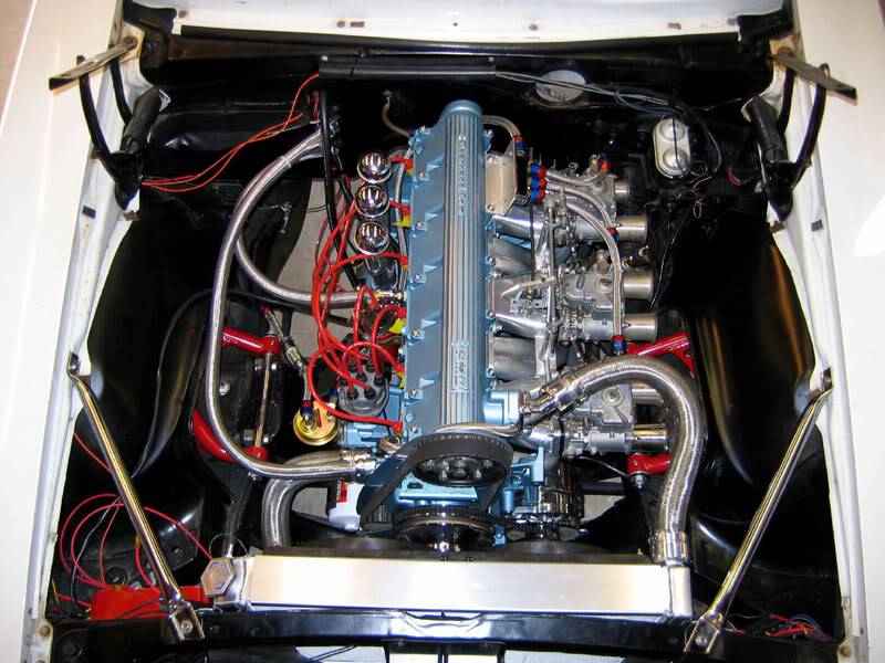

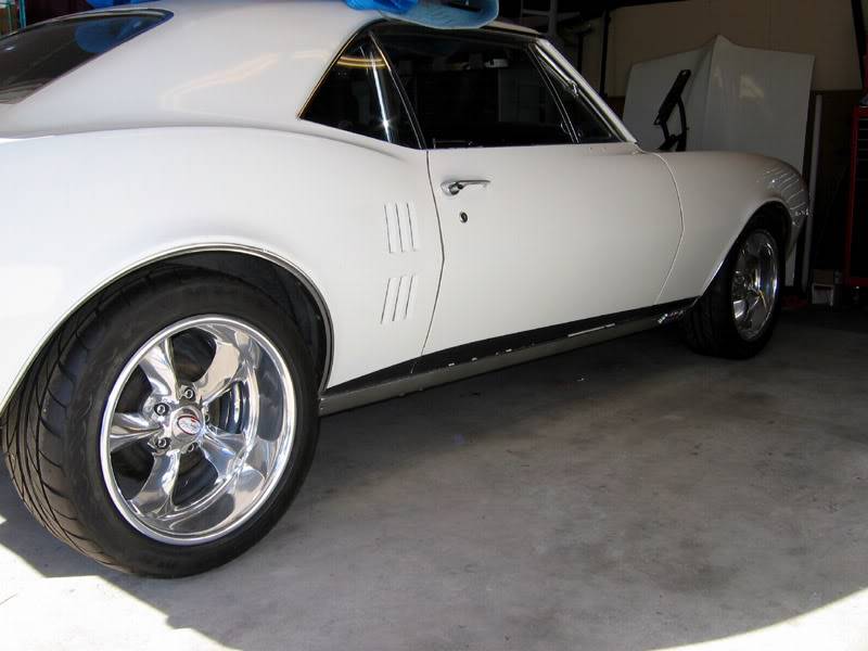

      I am running 17X10 5.75"bs 275/40 in the rear and 17X8 5"bs 245/45 in the front. Plan on running disc's all around.
      Sorry not the best pic, (a bit too wide angle)

      Gotta love that engine. Actually mine was same but engine is long gone. Somebody doing something different is refreshing. Do you have rear shot I am just curious how they sit in wheelwell in relation to the outer lip. I am going pretty low and just want a good starting point to set everything up. Thanks Brian

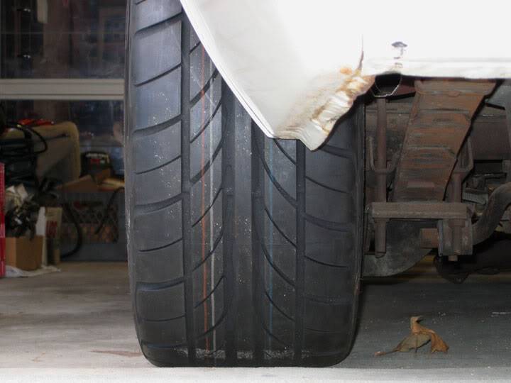

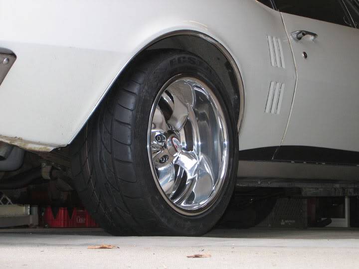

      Brian- Here you go. Keep in mind I intend in lowering the rear a little more and I curently have drums. When I switch to discs, it will move the wheel out .25". That's why you need to plan for discs or drum when considering back space. If your back space is too much you can use a spacer. If it's to shallow, your boned.
      What year do you have? The 68-69's have staggered shocks and may not have quite the same clearance and a 67. The 67's have factory traction bars and in 68 they dropped them and went to staggered shocks to help with axle wind-up.
      If you need some different pics just let me know.

      I really appreciate pics. If you could take shot from rear or 3/4 rear showing where tire comes in relation to outer wheelhouse lip. How high is your wheel lip from the ground. Thanks once again. Brian
