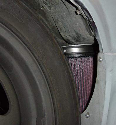

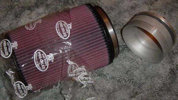

      This is my K&N can. It's 8"w X 12"t. The metal air intake adapter is 6" across on the big end, which gives you some scale:
      And although you can't seen the entire height, here it is in front of my pass. side wheel:
      Obviously not a setup for rain! I might make an airbox with a drain to cover it up, but I'm not really interested in a true daily driver.

      whytry, there's pix of the 6"-to-4" adapter I made at my site, about a third of the way down.

      Well, the inner piece is mostly pressed into the outer ring, and then my friend welded them for strength and security - it probably would have held forever without welding, but we're talking like a $25 job for a TIG shop.
