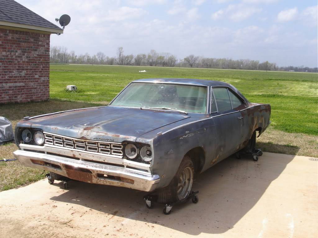

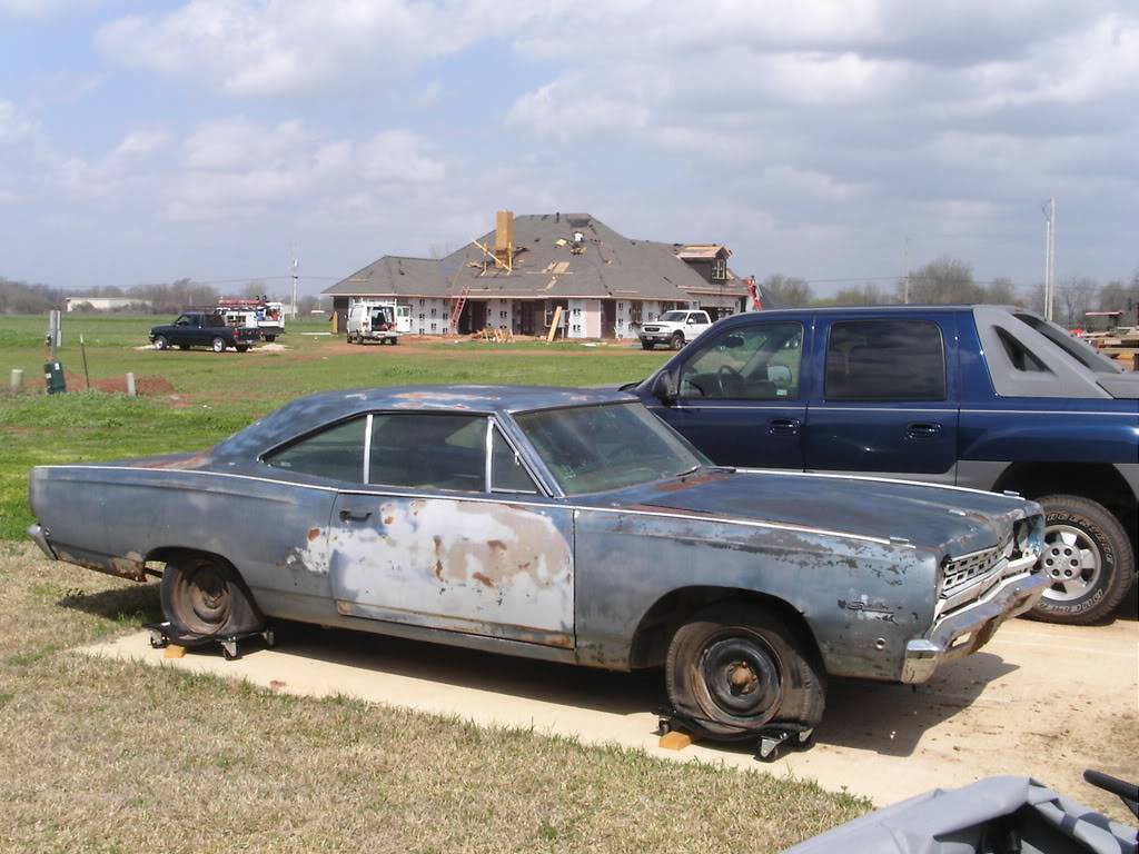

      I introduced this project last year, but the birth of my first child has delayed any real work on the car. I am finally getting some time to work on it. The time delay did give me the chance to work out a plan. Here are the details.
      Engine & Drivetrain:
      * Rebuilt 318
      * late model Magnum 5.2 heads and intake
      * Megasquirt fuel injection
      * Magnum 5.2 race headers
      * forced induction
      * GM 700R4 transmission with TCI adapter
      * Mopar Sure-Grip differential
      Chassis & Brakes
      * XV Motorsports Body Stiffening system w/ engine compartment brace, laser cut subframe connectors, lower radiator support, firewall to shock tower brace.
      * Mopar 0.96" torsion bars, Heavy Duty leaf springs
      * 1-1/8" front, and 7/8" rear anti-sway bars
      * polyurethane front and rear suspension rebuild kit
      * SSBC front and rear disc brake kits
      * Ruff Racing 280 black 20x8, 20x10 wheels
      Body
      * carbon fiber six-pack hood
      Interior
      * www.whitegauges.net white face gauge overlay
      * 2000-2006 Pontiac Bonneville front and rear seats
      Here is the starting point.
      Here is the goal. Sorry about the grainy image.

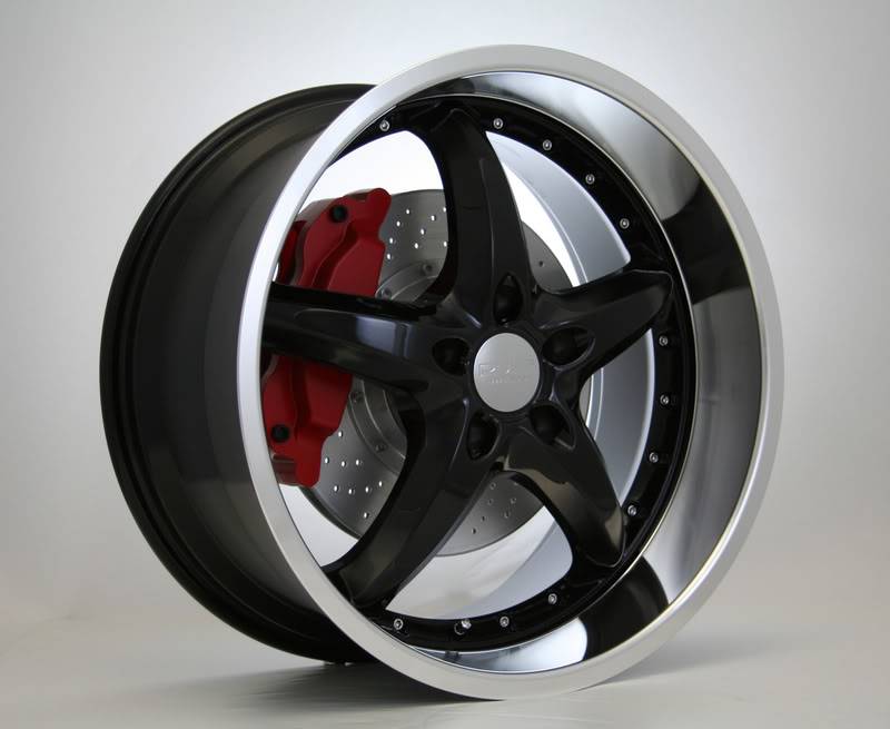

      Here are the wheels.

      Damn, with that is going to be a badass ride! I especially like the wheels
      51
      bad ass
      that is badass but why a lowly 318 and not something bigger ? if you want to stay SB then why not a MP 440 crate engine or a stroker kit for 360 ? other wise that bad ass ride turnsout to be a poser and we Mopar guys can't have that

      What are those wheels?

      The wheels are Ruff Racing 280's, in black. I plan 20x10's in the rear, with 18x8's or 20x8's in the front.
