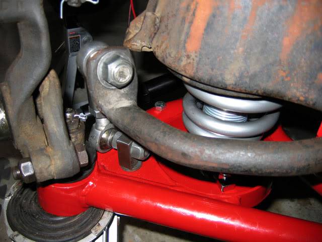

      You mean somthing like this?
      These are Herb Adams, circa 1983'ish. I cut the female end off a bit (just above the lock nut) so I could shorten the over all length because it was too long for my lowered (cut spring) front end.

      Solid endlinks aren't going to "allowed for better positioning of the sway bar to the suspension center pivot point". They will take some deflection out of the system and that will increase your effective bar rate. Might help might hurt. 99% of the cars on this site aren't developed enough to show the difference. There's plenty of places to spend money on a car. I don't think this one is at the top of the list.
