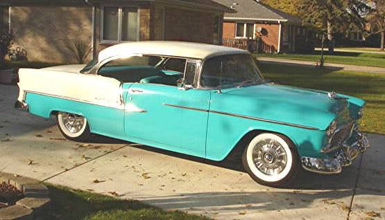

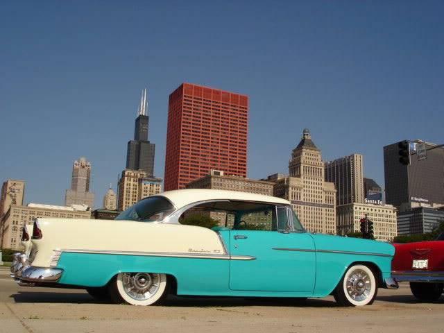

      My 55 Bel-Air is currently setup as:
      Front:
      QA1 12 way adjustable shocks (set al the way down to slam the car)
      Rear:
      Stock Leaf spring setup with 2'' lowering blocks
      My question is what kinda shocks do I need to run to help smooth out the ride out back ? Ever since I lowered the rear, the back of the car basically bottoms out (or feels like it does) when I hit a good bump. Is this becasue the stock length shocks aren't working with the rest of the lowered suspension ? If this is the issue (which I think it is) where should I look for a lowered shock (nothing crazy) that will work with what I have ? I plan to drive the whitewalls off this car this year, and want the ride to not be as harsh as it is now.
      As usuall, all help is greatly appreciated...

      take the shock off the car and drive it , what happens then ? still bottom out ? i have had a ton of 55's with the same setup and never had that problem, here is one that had the same drop leafs from speedway and it rode great ? probally the shock bottoming out not a leaf problem

      I will go with Kenny on this one. Have done several tri 5s with no trouble.
      Although we just had a packard in the shop that was complaining of the same thing. And it turned out the right shock was stuck wouldnt compress.
      If you still think you are having trouble with the shocks bottoming out. get under the car at ride height, and measure the travel from the rear axle to the bump stop. mark the shock installed on the car were the upper and lower half meet. remove the shock and see if you have enough travel before the shock bottoms out. compared to the travel you on the rear end travel measurement.

      Those are two killer cars ya posted there...
      I would love to throw on some big wheels & brakes on my 55, but i still have a few areas that need attention first (motor-trans-rearend-etc ). The wide whitewalls and 57'' Caddy caps will have to do for now...
