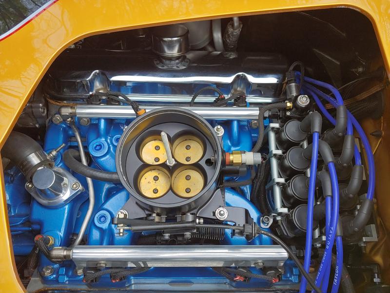

      Very Nice, is that a factory cast iron manifold or aluminum painted over. Also how many extra units do you have available?
      Thanks.
      Aluminum painted over. Edelbrock has a couple EFI ready intakes. I have 12 sets made. Redesigned the tooling for locating the crack trigger / reluctor which I should have soon.
      Send me a PM for more info.

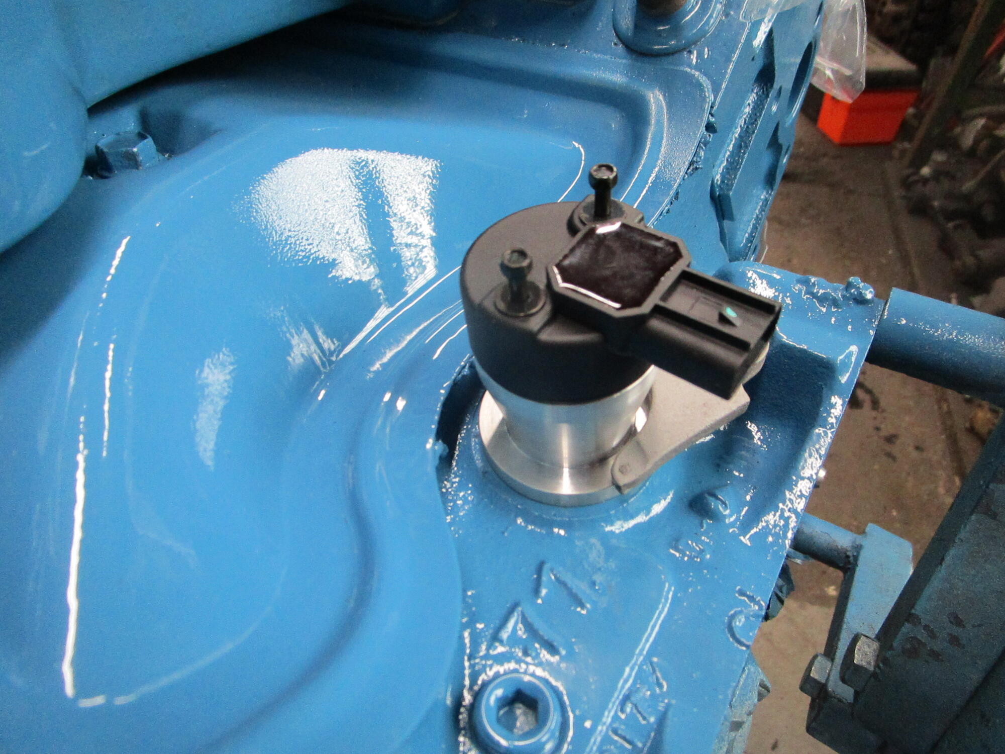

      Ryan - Cam sensor & housing take the place of the OE distributor. Crank sensor & adjustable bracket mounts off the OE fuel pump boss.
