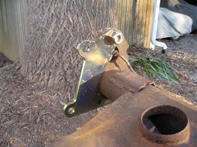

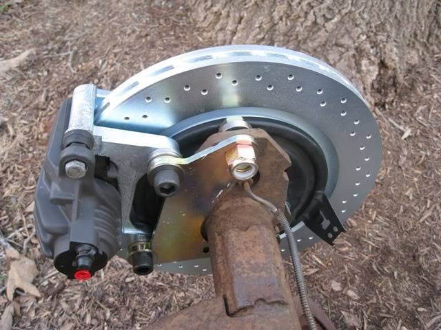

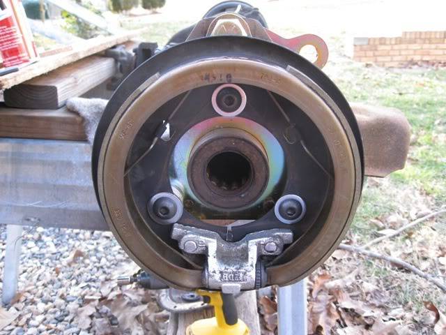

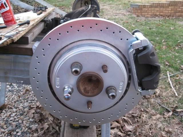

      Yep, done:
      http://www.nastyz28.com/forum/showthread.php?t=102394

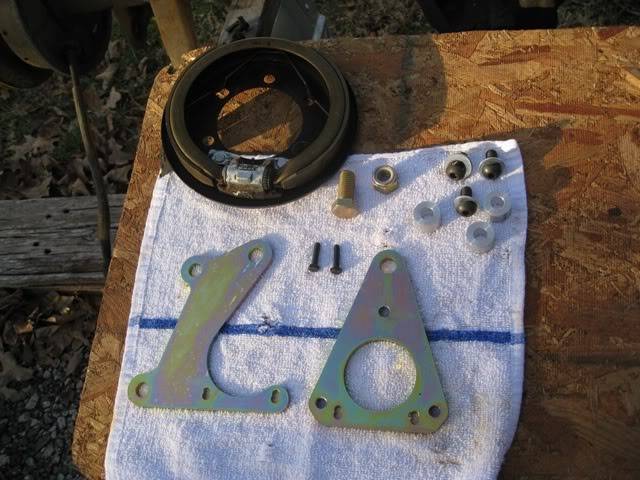

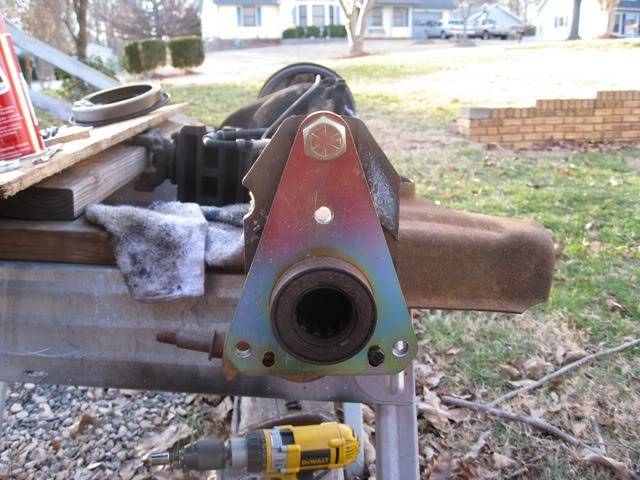

      On the bright side of things, the brackets and brakes WORK!!! You guys are sure to enjoy the following lot of pics. Again, the brakes are currently installed on a stock 3rd gen 10 bolt drum rear but with just a little work they'll fit up on practically any rearend with about 2.75" of offset from axle flange to axle housing flange, all I'll do is tweak the flange pattern as needed.
      Just a few things to note:
      1- I have a bit of tweaking with bolt lengths, spacer thicknesses, and shimming to get the parts exactly where I want them so it's not ready to offer at the moment, but at least we know it will work.

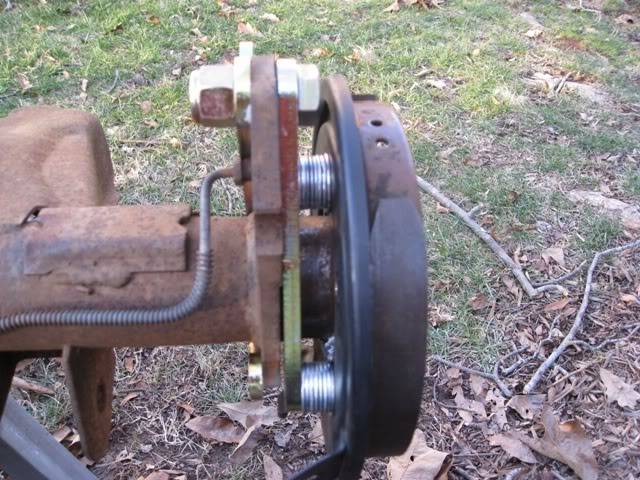

      2- I almost forgot that with these axles you have to push them in, insert the C-clip, and pull them back out. I'd like the C5 backing plate to come back out closer to the rotor the thickness of a spacer washer I used but at this time, it cannot. I'll explain that later.
      3- The two lower bracket mounting bolts will need to be drilled for a larger mounting bolt during actual assembly, as it will hold bolt plates to the housing flange. I'll do it for real later, just testing here.
      Pic of the parts I'll use: The bracket pair, aluminum spacers, various bolts, stock C5 backing plate

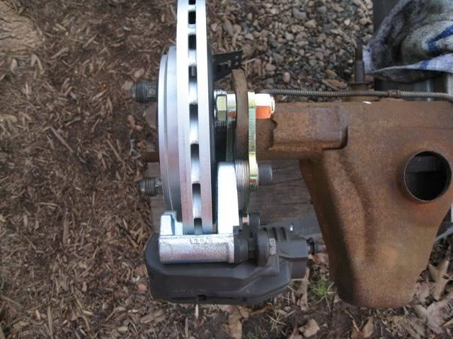

      Install the outer plate using a bolt through the old wheel cylinder hole and the two lower bolt holes. (These will be drilled for larger installation bolts). Install the inner plate using the same holes as the outer plate.

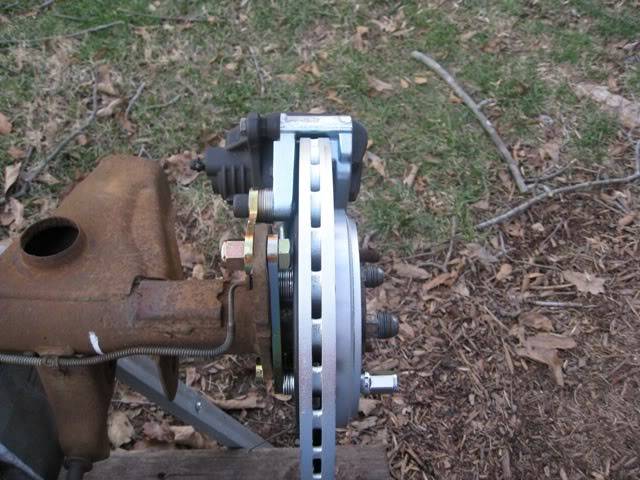

      Install the C5 backing plate with the 3 mounting bolts and spacers:
      Bolt on the caliper, hook up the brake lines and go:
      Aluminum spacers will be used on the backing plates and the abutment bolts. I totally forgot about the e-brake pics...a universal cable kit should take care of it and I'll incorporate a standard GM click type cable mounting bracket on it somewhere. Also, with these brackes the caliper can also be mounted on the front of the axle...just turn the inner bracket around. As they are currently installed, the e-brake cable will pull to the front of the car. More to come, let me know your thoughts..thanks!
