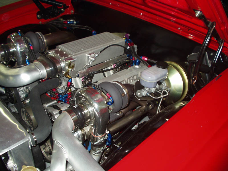

      Was wondering if anyone knows what type of MC Mark Steilow used on that car. It looks like a C5 type on an old style vacuum booster. Also, what brake setup (front and rear) did he use? Any help would be appreciated.

      C5 Vette MC
      Yes - that is indeed a '97-'02 C5 Vette MC on the Malitude. It is running the big Baer discs on all 4 corners, though cannot tell you exactly which ones (didn't look closely enough).
      This particular mc is cool in that it offers a nice clean late model appearance, light weight construction, 1" bore disc / disc spec, and will fit onto most all GM based power brake boosters equipped with the later model shorter mc rod (mc pushrod sits about a 1/4" below the mc mounting surface vs the older version that stuck out about an inch past the mc mounting surface). Watch out though, as this mc is $200 new, and uses the PITA metric ISO bubble flare type line connections.
      I have attached images of the front and rear brakes used on the Malitude for you guys to check out below.
