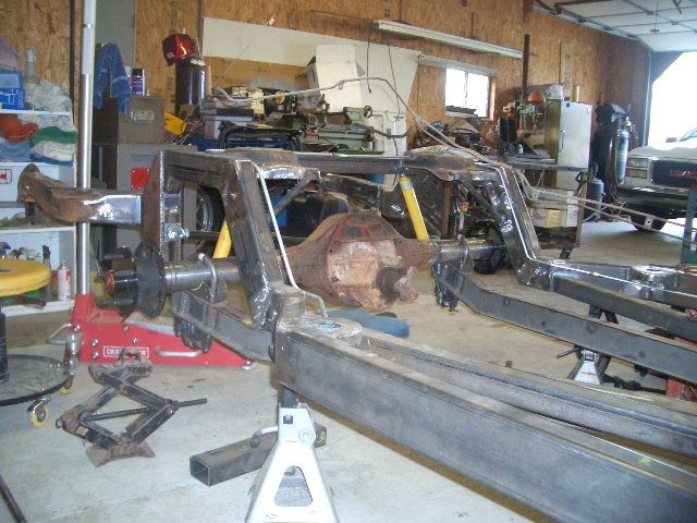

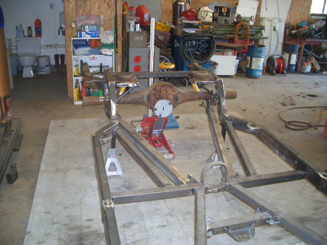

      HTH advertises that you can still run exhaust out the rear w/o a problem. Out the sides is very doable, but getting it quiet might be another story because of how short the exhaust will be. Also, you have a t56 in you car correct? That will also make running any kind of x or h pipe a little more difficult. I am building my own truck arm setup, and my exhaust guy is already dreading the job. Mine makes it more difficult because I have more bracing in mine that HTH provides w/ their setup. I am sure you have seen pics of mine before on the montess site, but for a reminder and those who haven't here are some pics.

      I can't run my exhaust out the rear because of the crossbar behind the axle for my shocks, and strength.
      Good luck w/ your decision.
      Joe
