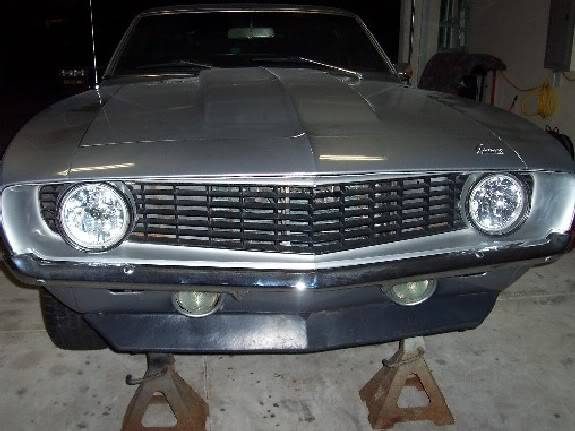

      Not really a good pic but I changed out my headlights for some Diamond Clear Lens with an H4 silverstar bulb, and since i added relays to the headlights the light is REALLY white

      Very nice!!! That's the look I'm goin for. Where did you get your lenses?

      There actually those APC Euro Clear lens I got at advanced haha
      ...but im gonna change them once again for some projector headlights with the angel eye around the edge
